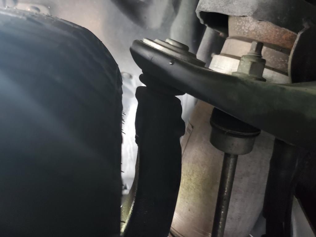

Arman
Apr 2, 2020
26
23
02138
2015 LR4, Photos of a gap between front upper control arm and Yokohama G015 (275-55-R20) on LR058061 wheels (bolt - 5x120mm, diameter - 20", width - 5.8", offset - 53mm)
Gap is about 1/2", doesn't change much in different height modes
Shaft1980
Feb 23, 2023
Maple Ridge, B.C.
Thanks for this, Reviving an old thread.
I also have a 2015 LR4 HSE Lux with 20" wheels exactly the same spec, I have mounted Nitto EXO Grapplers in 275/55/20 and they hit the front control arm. I am so upset! They should have fit but I don't understand how there can be a half inch difference between manufacturers.
