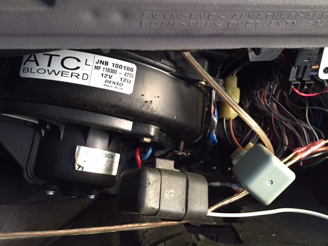

A little lost
I do not see how to remove the fuse holder assembly under the hood to look for corrosion.
Fuse holder under the hood is a PITA to take apart.
In the picture you see the red and blue wires going into the fan assy, they are you power wires, they should go to a relay, check the relay for power if none, that is where you want to run a hot wire to, then when you turn on the vehicle the relay will kick and allow the fan to work.
There is power at the relay. I can feel clicks in the relay as I change fan speed. Coul the resistor pack in the blower unit be the issue?
Wow, haven't seen that before... take the fan apart and make sure the bird cage isn't just full of crap
bgbrown125
Jul 9, 2007
15
Took it to my mechanic and he states that it is the blower resistor. Now I just need to find one at a decent price
