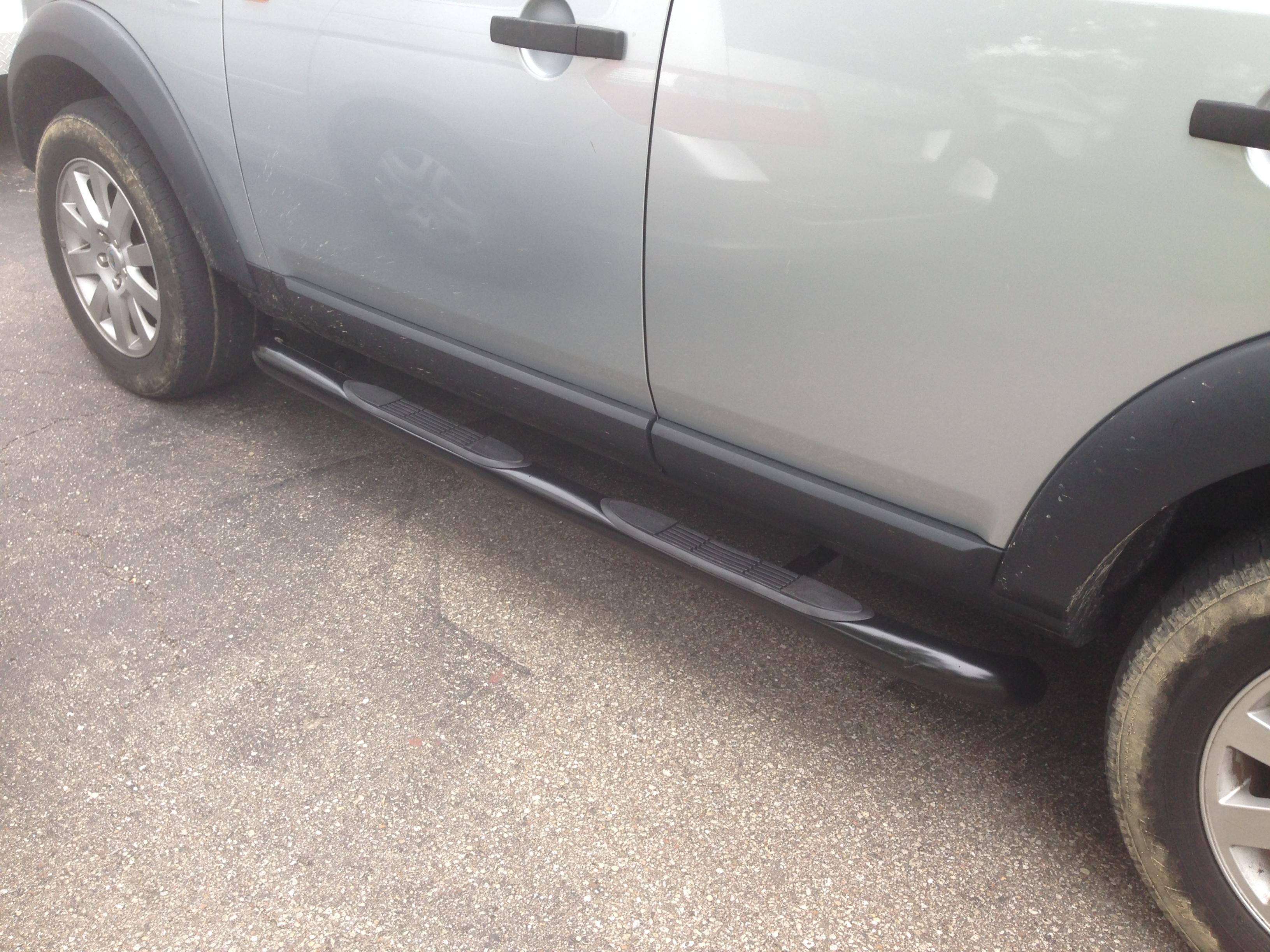

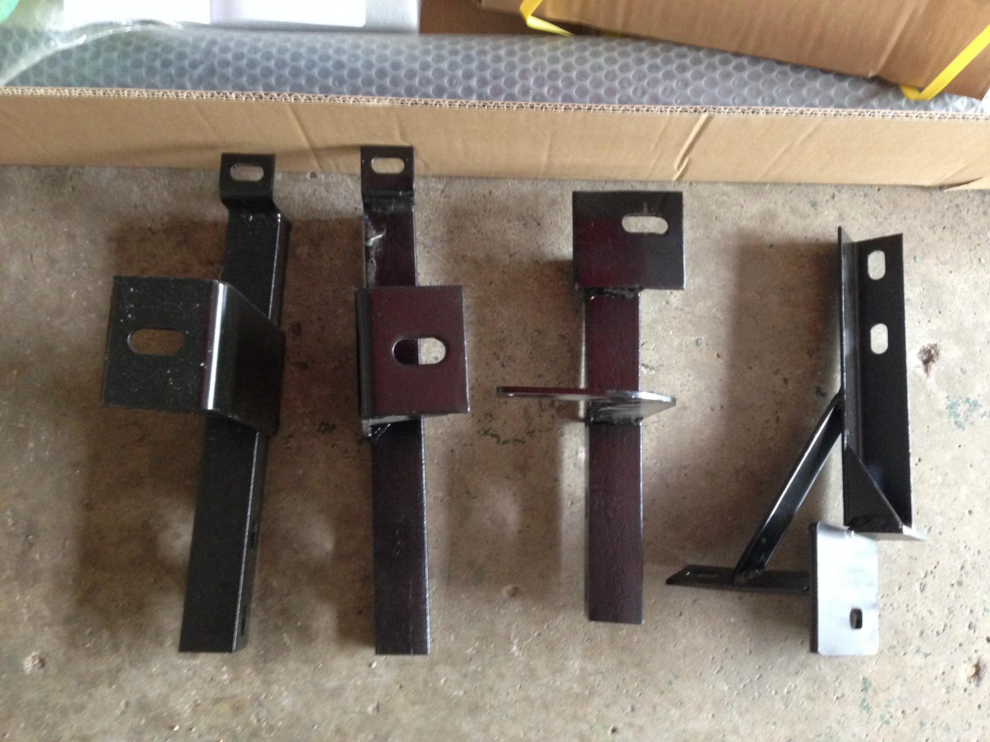

I got my ebay nerf tubes yesterday.
The tubes are a nice strength for steps and the brackets are very stout. The front brackets use one of the body mounting bolts that are on the truck now, but the bolts that it comes with are a bit smaller than I would like..
I got the driver's side installed..... after I broke one of the bolts.. Sheared right off as I was tightening it..
I have an email into the seller now about more and/or stronger bolts..
I will also stop at the hardware store and see if I can get something a little beefier to use on my way home...
I think they look nice, and they do what I want, which is to help my wife and kids get into the vehicle.. I don't do heavy off roading, so I'm not counting on these to be rock sliders, just steps. They take away about 1.5-2" of clearance at the sides...
If we like them and use them maybe I can justify the 10x cost difference to go to the TerraFirma sliders in the future.

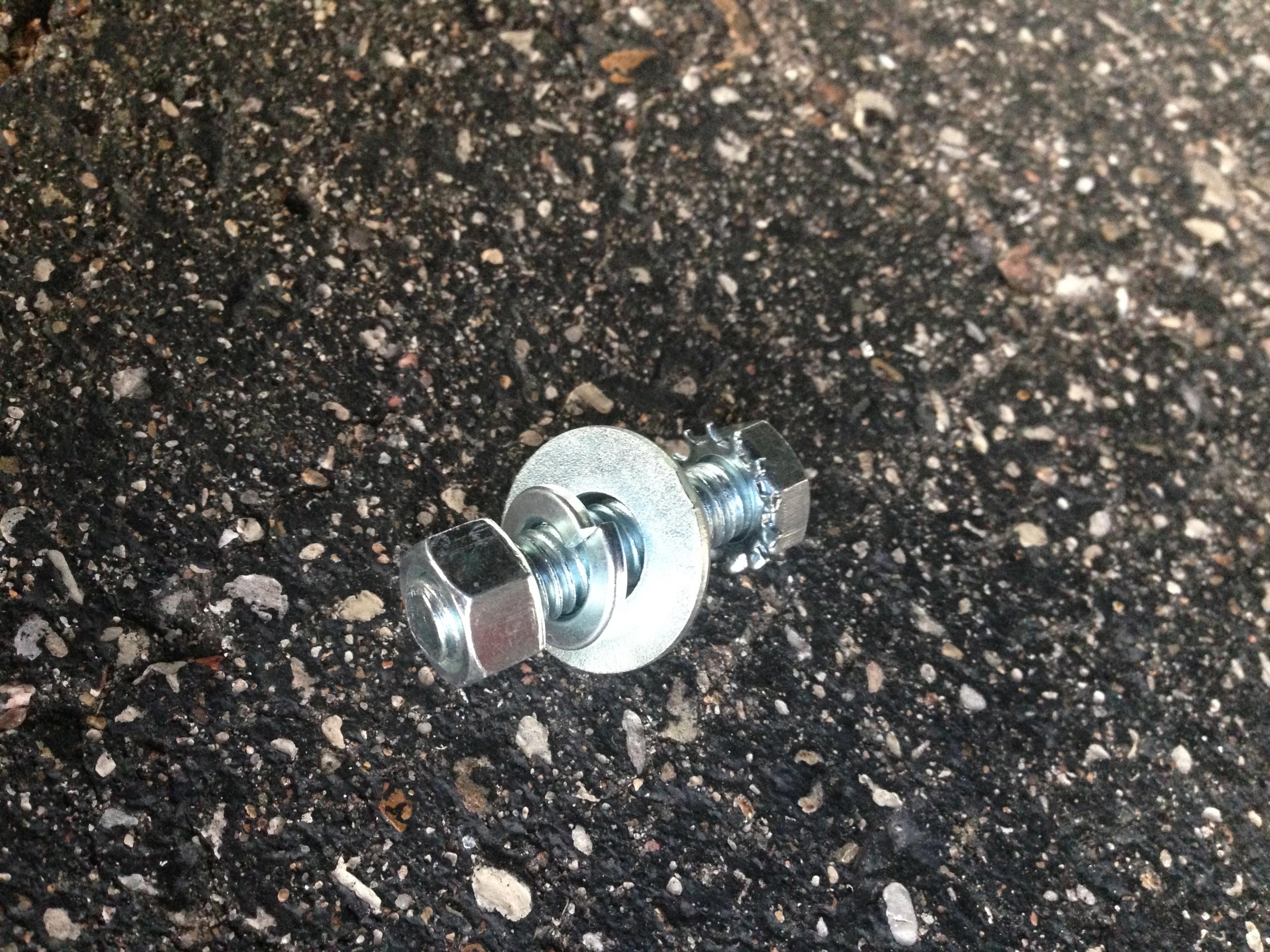

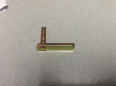

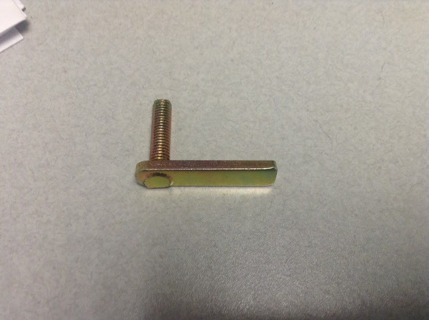

Here is one of the bolts that I broke...
Looking for alternatives tonight..
If I can't find anything, they will be sending me a few more.

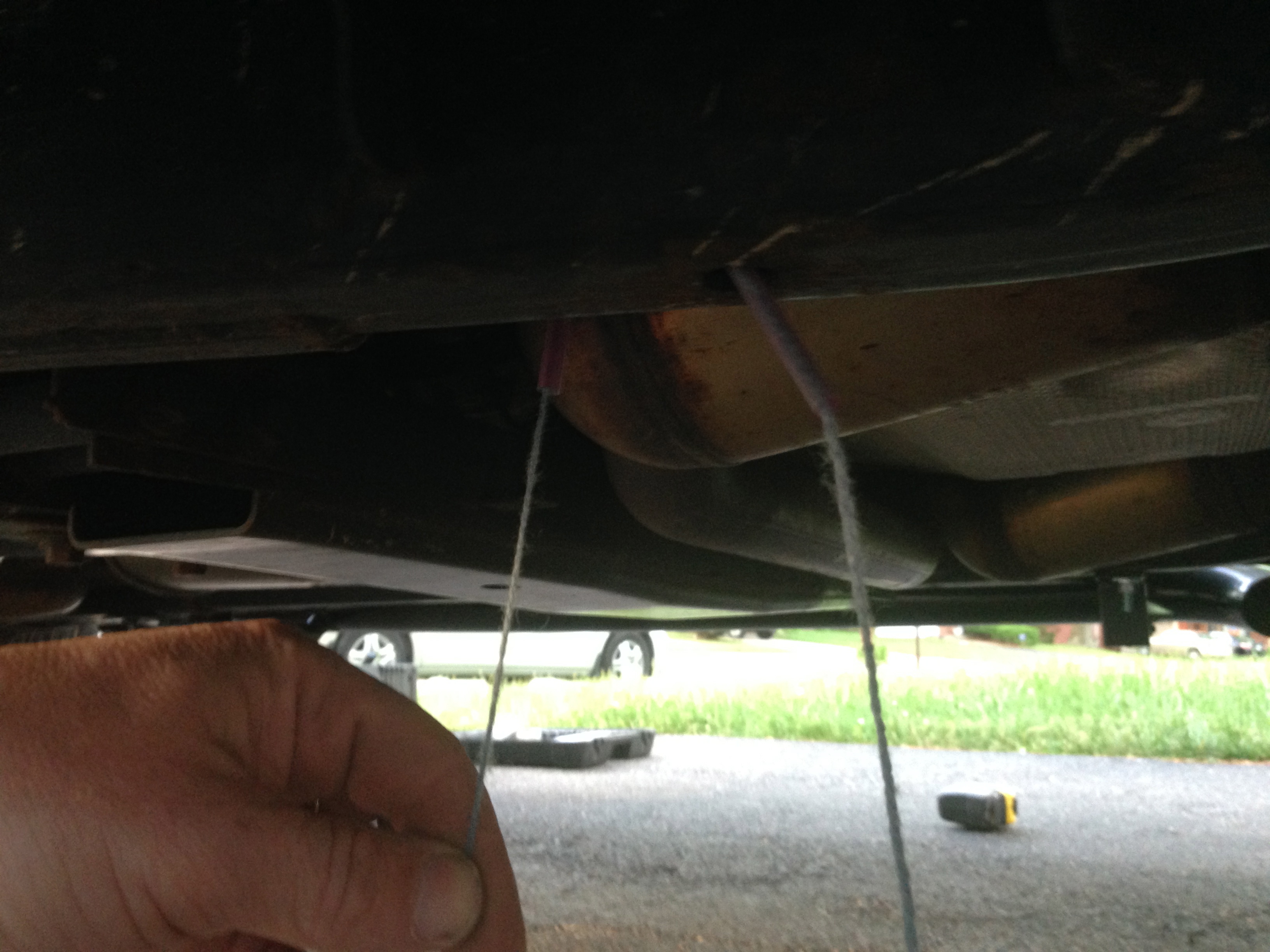

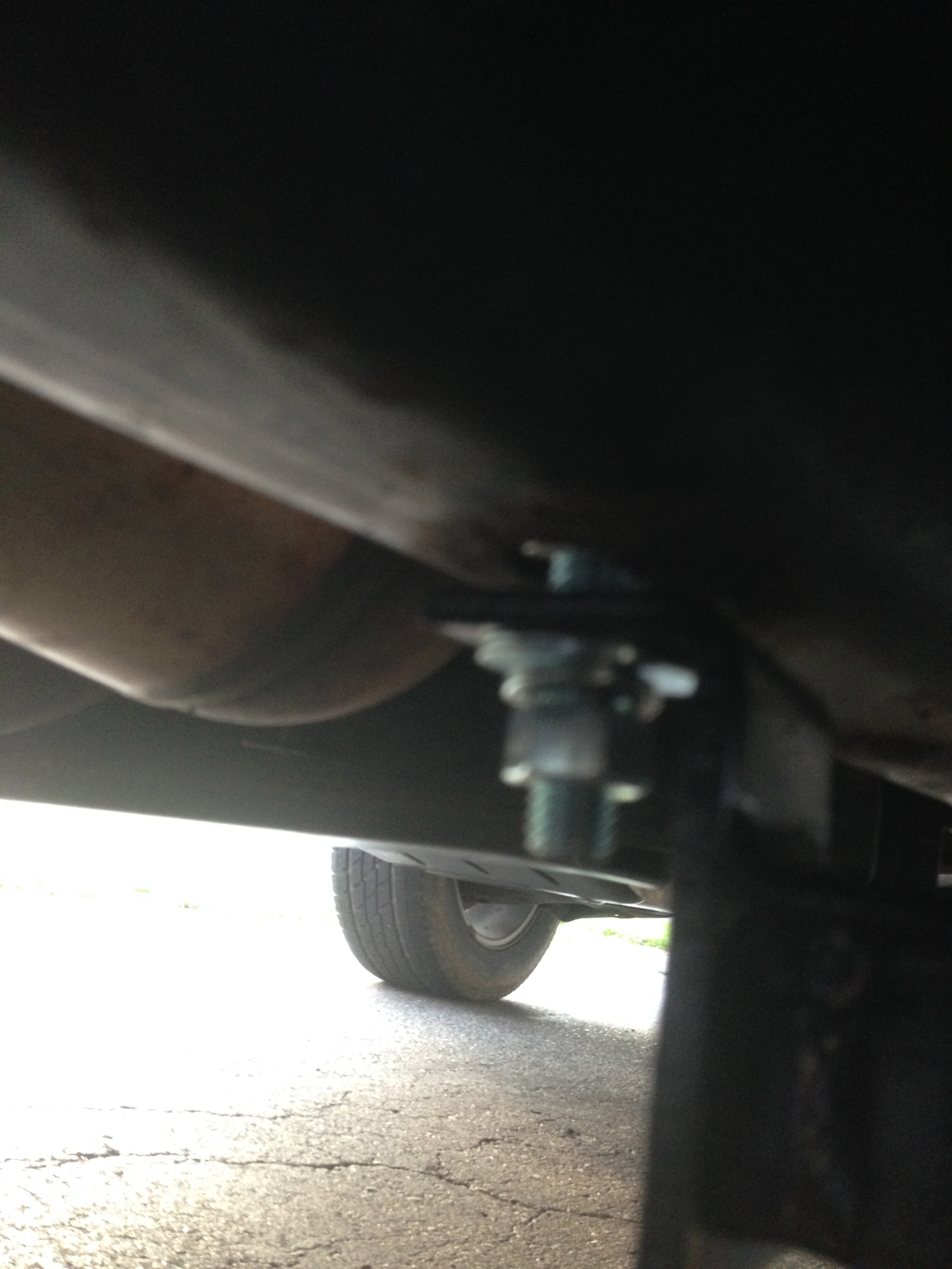

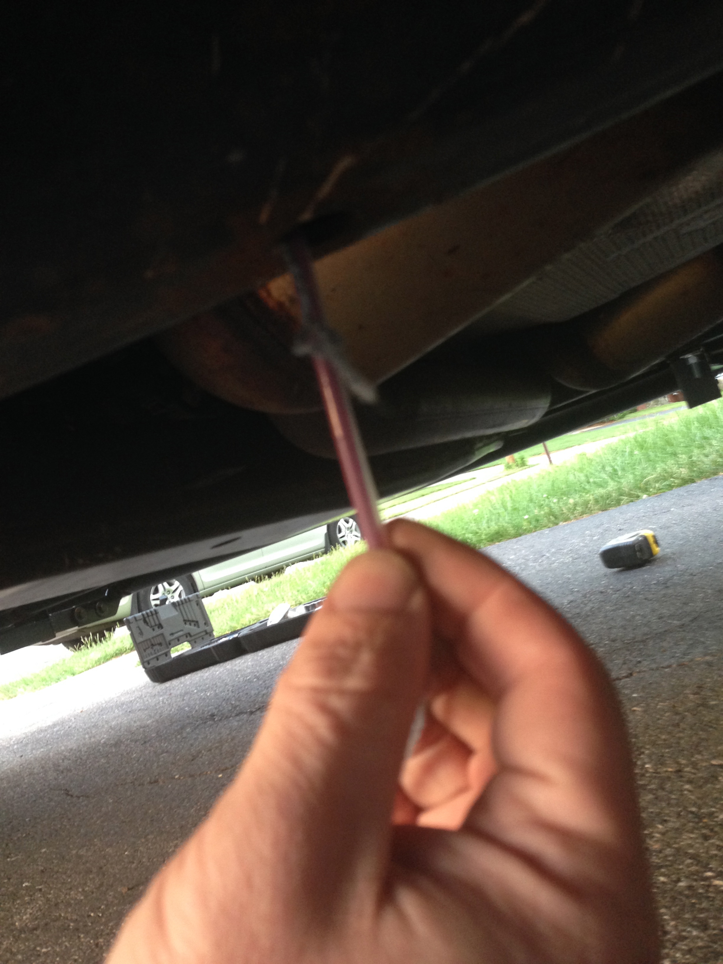

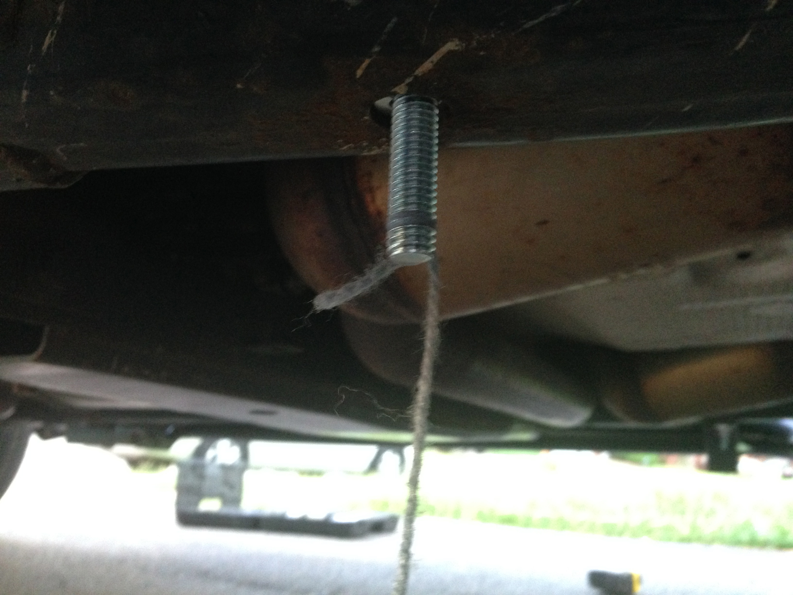

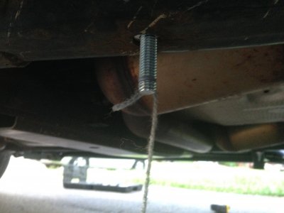

I was able to pick up some bolts.. I was able to make them pretty snug, but not super tight.. Hopefully in the future I will get to snug them up a bit.
I used 3/8" bolts, and used a straw and a piece of yarn to thread them through holes in the frame to get to the right holes…
The passenger side is put on with three of my bolts, and the existing body bolt. I switched one of the front bolts on the driver side with one of my bolts, and was able to snug up the 2 bolts that were supplied with the kit a bit more without them breaking. Will try to snug everything up again in a few days.
I am able to bounce on both nerf bars without them flexing too much. I weight 160 lbs, for comparison.
