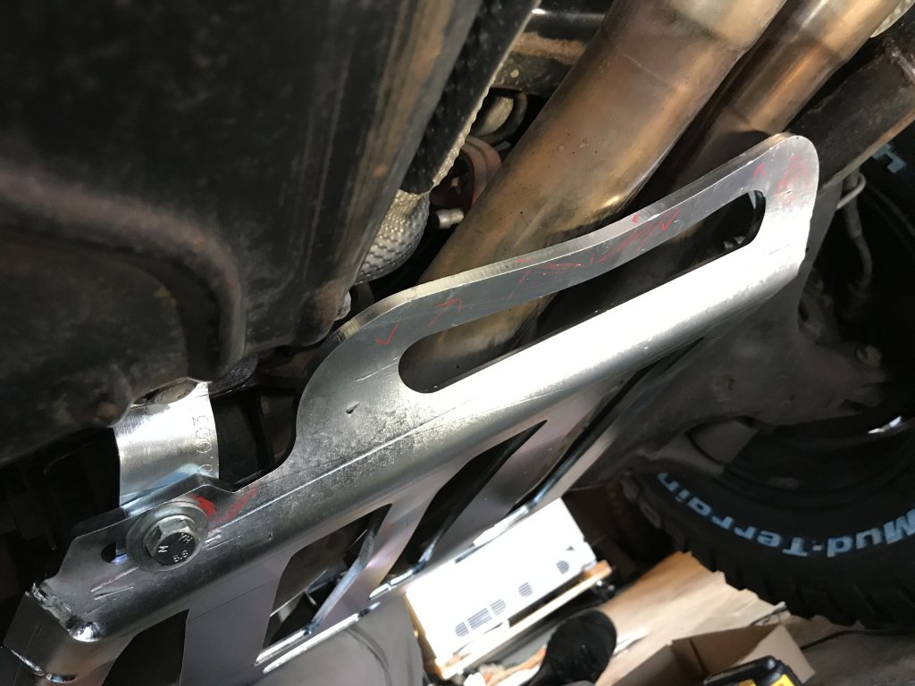

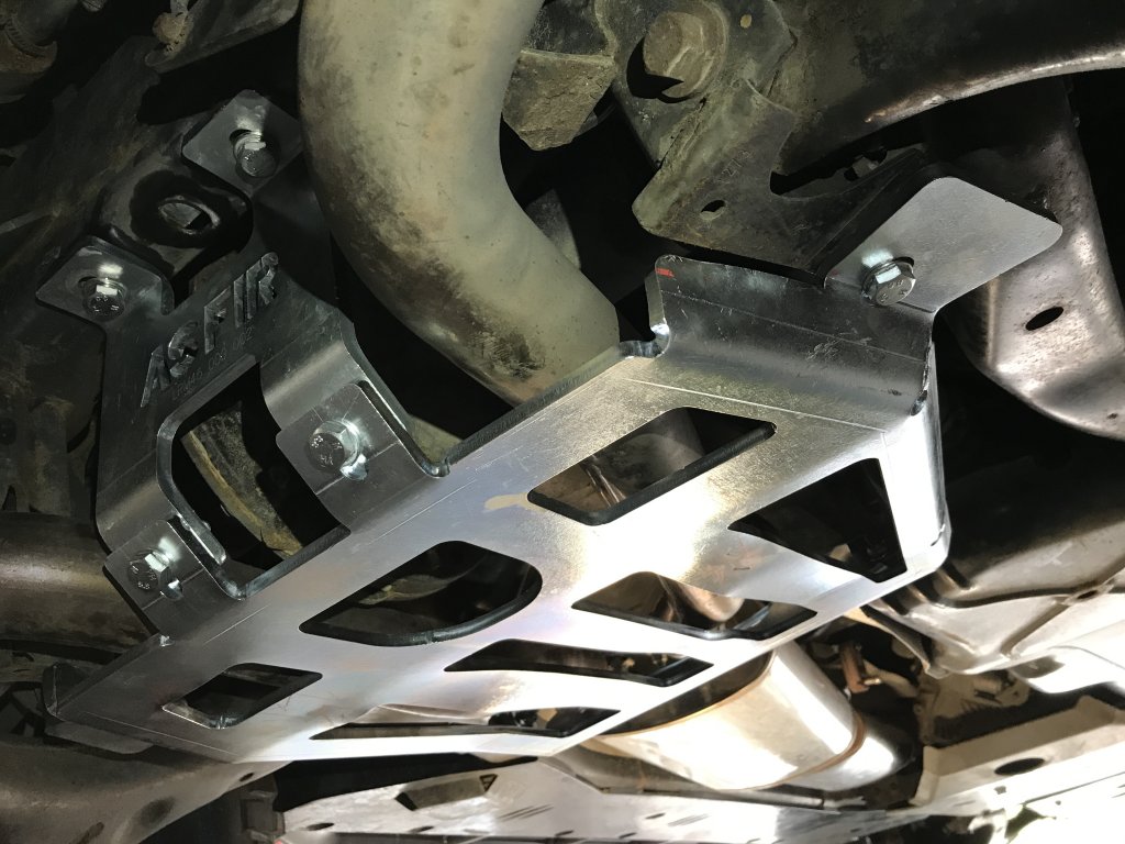

Seattle WA
Installed ... after at least 30 stages of bending 13 locations. The ASFIR engineers didn't account for the future potential of enlarged aftermarket exhaust tubes!
This now represents the lowest clearance point and is right at 14" on maximum height. At the slider it's 17-18" front to rear. Not bad considering it can also get inside a standard 81" garage door with a rack still on.
For respective, a solid axle vehicle with 36" tires will loose about 5" at the differential 18-5=13. This is what's so awesome about EAS when configured to its potential.
