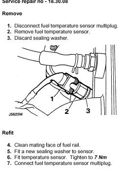

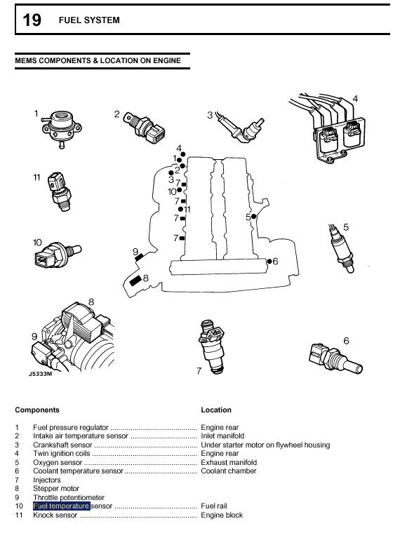

What is the sensor located on top of the thermostat housing behind the alternator? Or is it the fan switch?
I ran a temp/impedance test on the fuel temp sensor and it seems OK so I'm looking for other possiblities for my hot start problem.
Any and all feedback appreciated.
