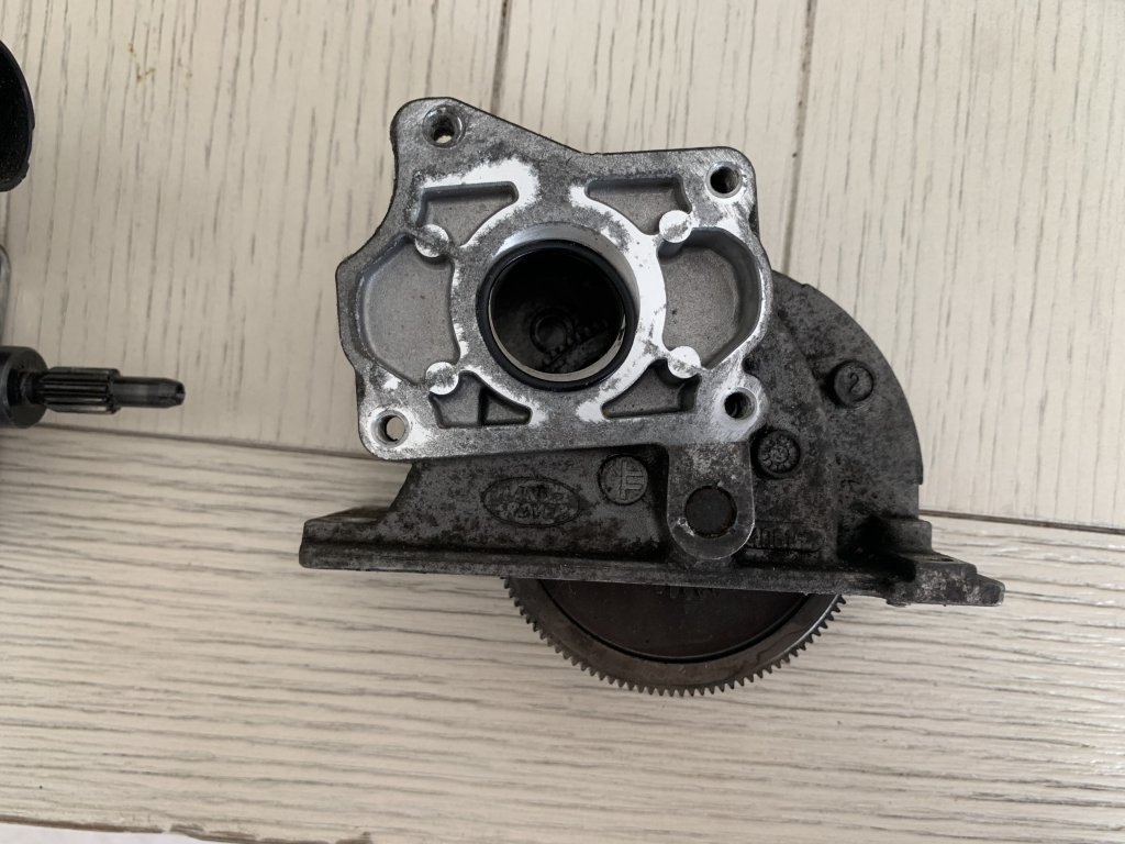

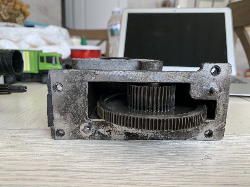

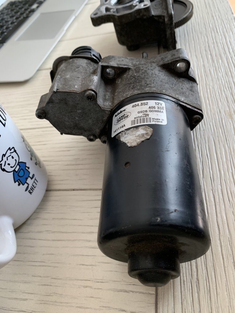

in the photos you can see the locating dowels these are the hardest to line up, so take your time.
make sure that you thoroughly clean the surfaces of the diff and the new part. After scraping I use alcohol on a shop towel. You ned to have them spotless for the loctite to really do its job as its the only thing keeping the elements out of the differential.
before you start this make sure you really inspect the new part for any damage etc and make sure you have all the tools on hand. Remember the loctite has a shelf life and this will be printed on the tube you don't need much 75ml is plenty enough, although I bought a 19 buck tube off amazon, so not the smallest. when you use this for the sealing faces squirt some onto a piece of cardboard etc so you can gauge the curing time for your circumstances.

In my case as soon as I took the old motor and gear assembly apart I realized that the motor was stuck.
The gear assembly was fine.
The motor has a braking mechanism to hold it in place at the required locking / slip level for the differential and this brake was giving me the error codes as the car was saying give me a fully open diff and the motor was stuck a couple of degrees closed.
I freed this and cleaned everything up, now I have a spare sitting on the shelf. :) so have a look at yours before you send it to the big parts bin in the sky.
