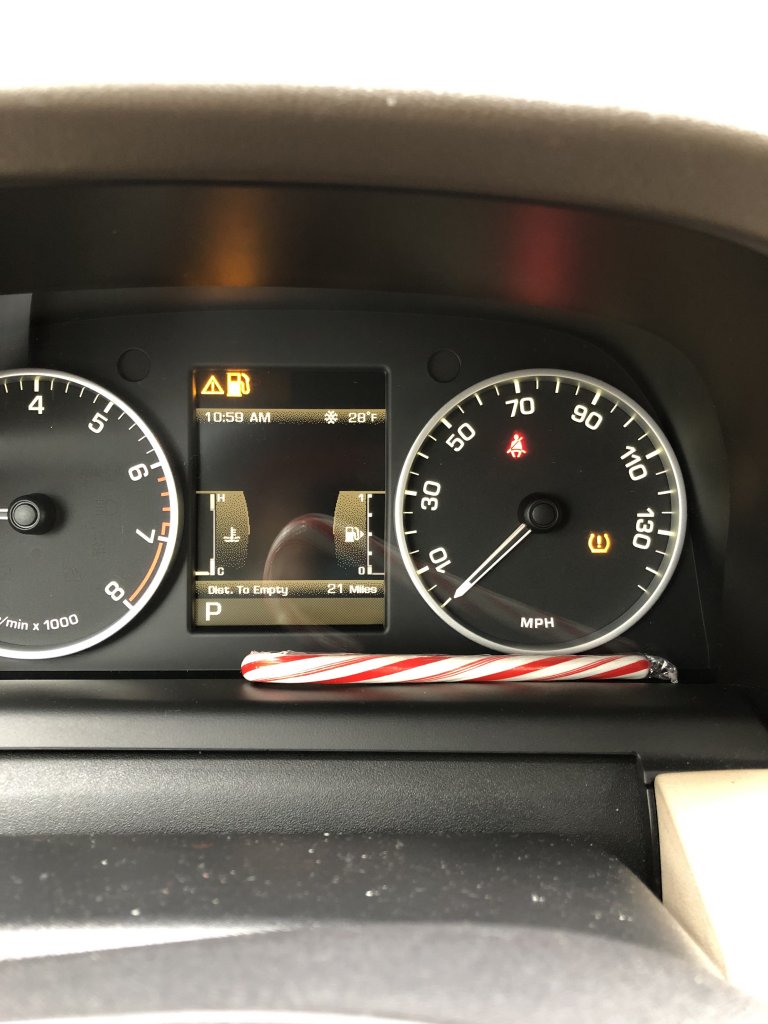

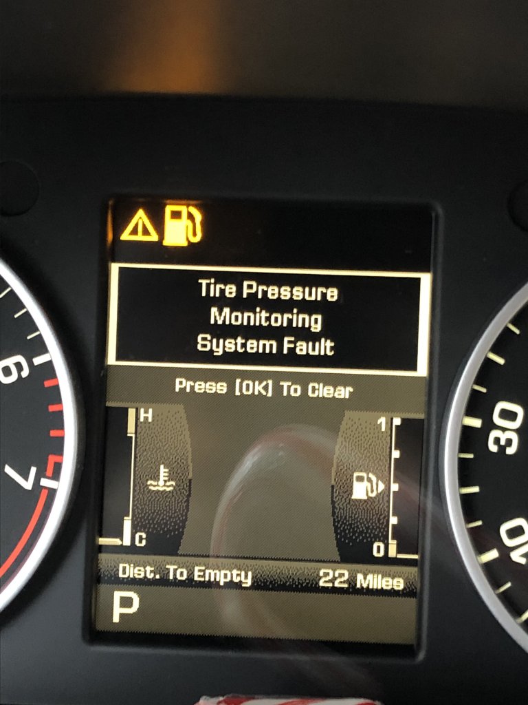

This popped up last night (last issue for 2019!).
"Tire Pressure Monitoring Systems Fault"
I check and cleared faults with IID but I did not see a fault for the Tire Monitor.
Few days before I got a warning that one (RL) was low. It was a bit low so I put air all round then the warning went off at driving.
Jaguar Land Rover North America is recalling 28,037 2014 model-year Range Rover and Range Rover Sport SUVs, along with 2013-2014-MY LR4 SUVs, so dealers can update software affecting readings of the tire pressure monitoring system
