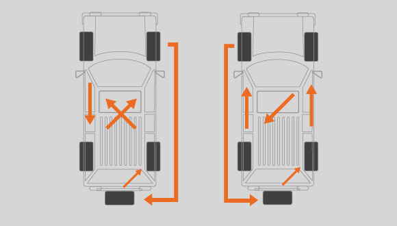

Why rotate "to opposite end of same axle" (except omnidirectional tires)? Front to back evens out the wear profile so well and at 16k our fronts are much more beaten up from rocky roads.

No idea, I rotate front to back. Seems that when I have tried changing the rotation I get more vibration. Front to back rotation at each seasonal changeover works just fine.

Yea, I always rotate my tires (including the spare) the following way:
**Four-wheel drive should use the rotation pattern on the RIGHT of this photo**

What page is rotation on in the manual? I cannot find it.
This is what I have been doing with my BFGs for last 34,000 miles every 5,000 miles. I will be getting new TA KO2 soon and thinking about rotating every 3000-3500 miles. ( five wheel rotation).
How often do you do your rotation?
Surfrider77
May 17, 2013
900
127
We are in kms over here and I am a bit lazy, so I just rotate every 10k kms which is about 6200 miles.

Haleakala,
That quote about switching from side to side of the axle is on p.31 of the Passport to Service booklet enclosed with the manual.

Oh, thank you. I only checked the owners manual.
