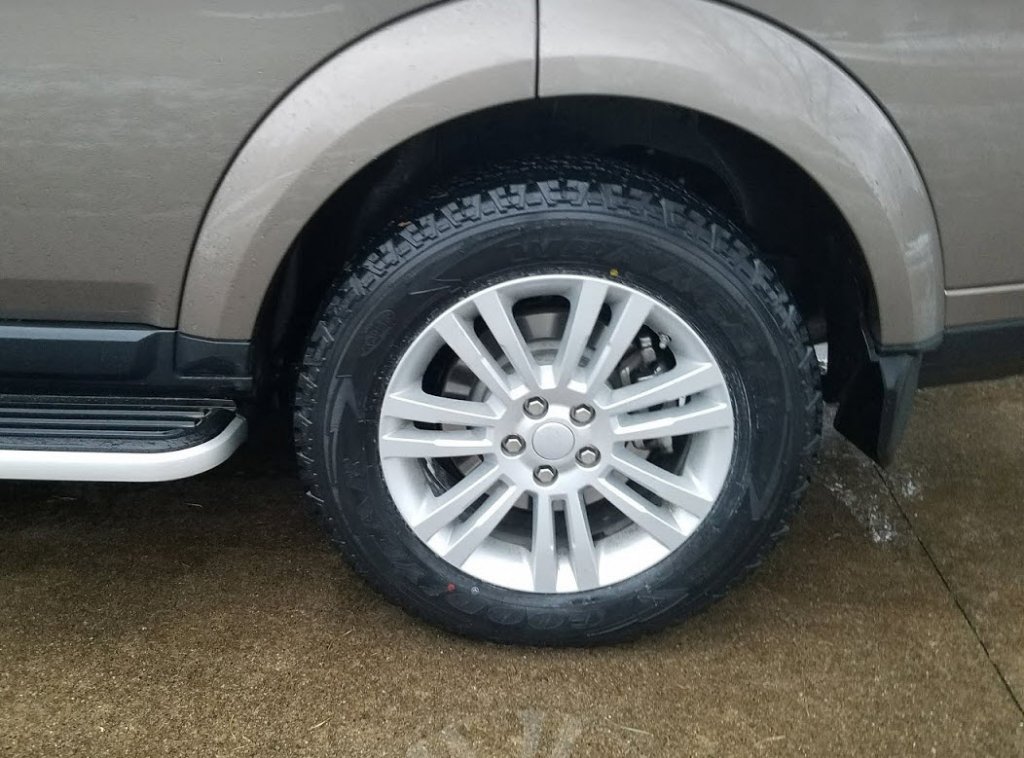

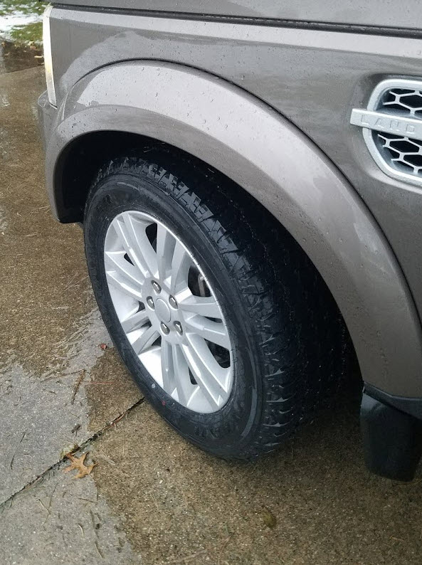

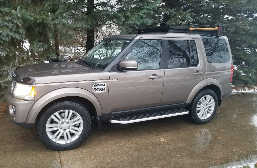

Well I bit the bullet and took off the barely lightly used Conntis that came stock with the LR4. it was a tough choice between the new Continental Terrain contact and the 1" larger Goodyear Wrangler All-Terrain Adventure. They were put on this weekend and I had plenty of snow to play in to validate my choice. They are smooth, look good and and stop/start and corner in the ice/snow. Could not be more pleased.
I was a little concerned with the additional inch at first until I found it still fit in my garage.
The size I went with was a 255/60r19.
Anyone need a set of the stock Continentals with 7-8/32" left???
