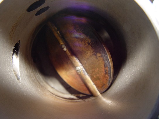

While I'm posting photos and messing with the intake area, have a look at this:
See second attachment.
Is that dirty or what? hehe. That was after I wiped off all the dirt I could. I have since run most of a can of throttle body cleaner through it with the engine running, similar to the method prescribed to Seafoam type products.

Its not that dirty :) To get complete idea of how bad insides are - just take off plenum cover. Then you will get better picture
