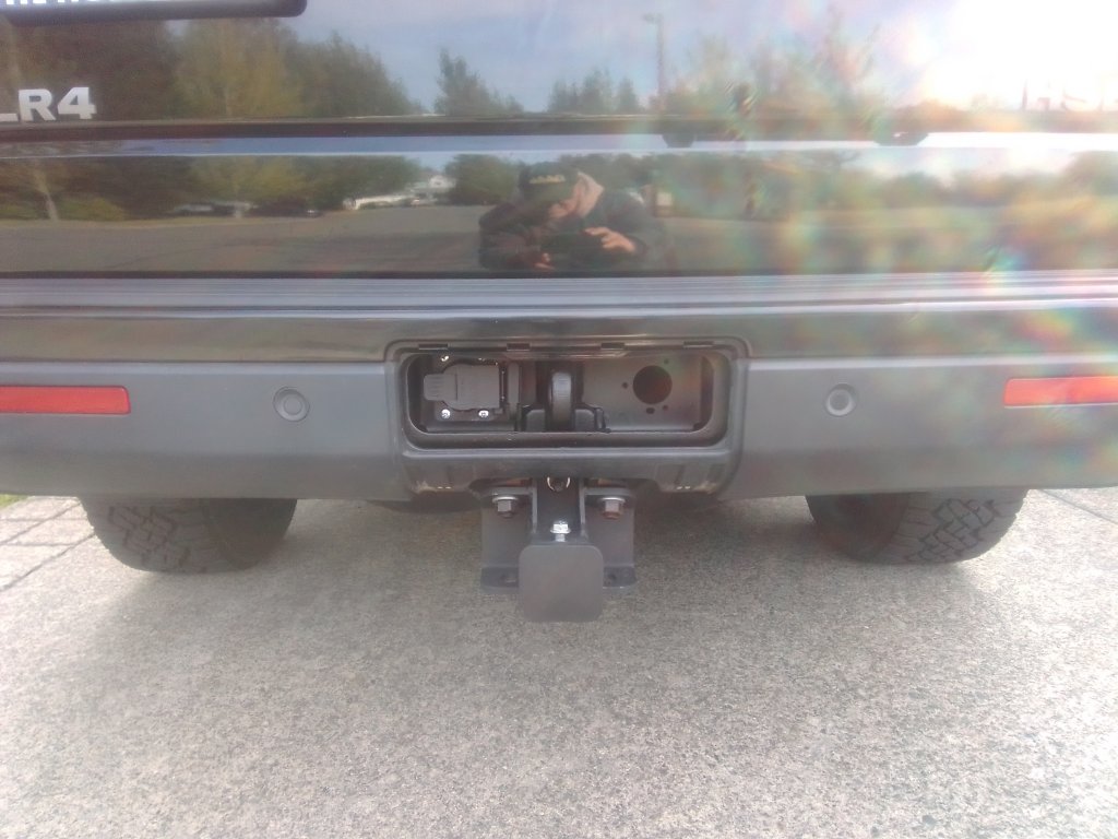

Sometimes it's the little things that bring the most satisfaction. The rear bumper area where I mounted my wiring plugs had a significant and noticeable coating of superficial rust. I taped off the surrounding area and trailer wiring connectors with blue painter's tape and extended the covered area with taped on paper bags to protect the vehicle. Sprayed the enclosed compartment with Rust-Oleum Rust Reformer. Super happy with the results.
