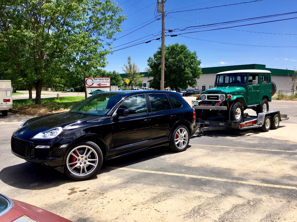

I thought it was a little ridiculous, too. Hell, my old Cayenne GTS came with one as standard.
No worries, though. The harness install is straight forward, and Atlantic British provides very thorough instructions. I definitely recommend theirs.
