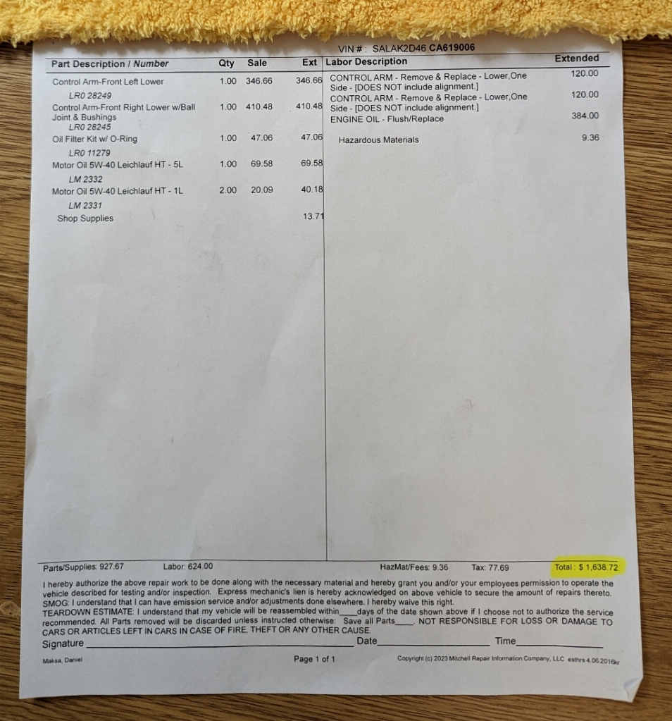

There is a mechanic within walking distance and he was supposed to be a Land Rover expert. They did have land rovers there and I dropped my LR4 off this morning, but they wouldn't align the car after replacing the A-Arms. He said I didn't need to and I didn't believe him. The oil change cost is stupid and he wasn't shooting straight so I didn't get the loose suspension fixed as I had hoped.
At least now I know that is not the place I could have gone to get my car fixed lol. My problem is I need a ride when dropping off/picking up and those uber ******* want to hold onto my CC. The only way to remove my CC in uber is to add another CC. F them. I rented a U-Haul truck instead since I live right next store to one when I needed a parts run when the LR4 was getting the crossover pipe done. Uber wanted $20 for one way and I got to drive a new Silverado, do burnouts, race people and get my parts for $38. All on my own time and I didn't need to wait on anyone lol. It was a lot of fun.

FWIW- Last oil change at my LR mechanic was $275 total ($119 labor...less than an hr.). Yes, it should be 8L and 0w20 is spec.
The Liquid-Moly 'Leichtlauf' is good stuff...about $42 retail for 5L, but Liquid-Moly also makes a Special Tech LR 0w20 (or 5w20), it's a few more $'s though. It's uber (no pun) cheaper to do yourself. Then again, there's your time and convenience.

No one in California or Texas needs a 0W lol. LR squeezed another .001 MPG on the EPA test dropping from 5w-20 on the V8s.

Seriously, do the oil and lower control arms yourself. Get everything from FCPeuro.com and it's lifetime warranty, including the oil.
Oil changes on this is stupid easy, remove oil cap, insert "Fluid Extractor" tube on the tube, hand pump fluid extractor to extract fluid until "empty", remove/replace oil filter, remove fluid extractor, add oil, replace oil cap, warm it up, and shut it down for 15 mins to check oil level. Why pay someone $100+ in labor?
