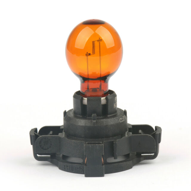

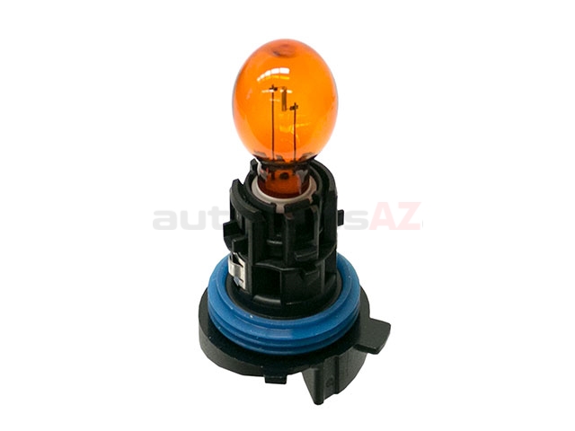

I'm having some trouble figuring this one out too. My manual says its a PY 24W for the front but any of the PY24w bulbs i've tried do not fit.
The first image here is a PY24w
The second is what my bulb actually looks like.
You can see they're close but the actual bulb has a much longer stem.
