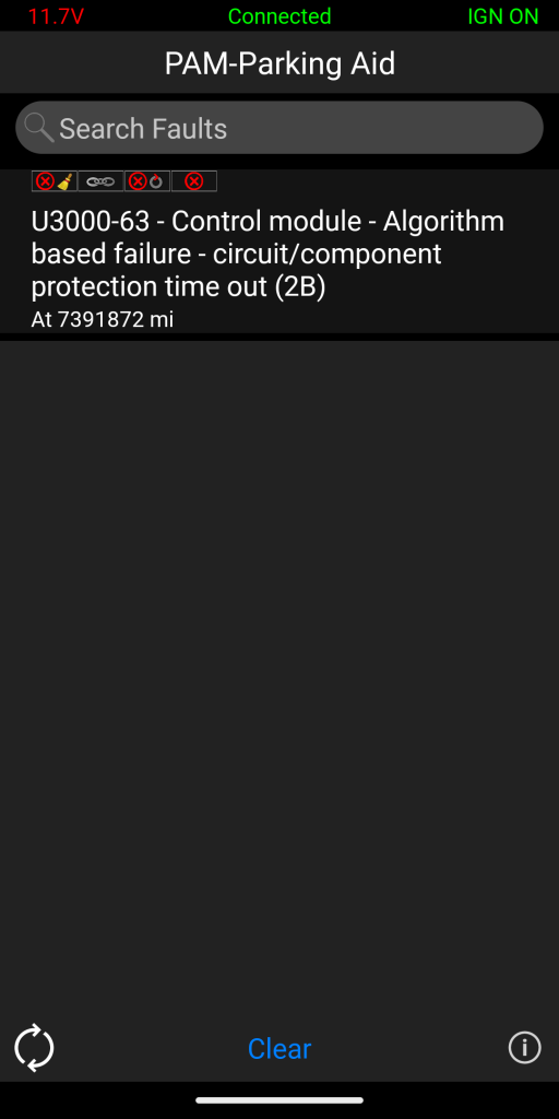

Installed the terra firma rear tire carrier on my '15 LR4 last fall and it would intermittently trigger the inner passenger side back up sensor. Fast forward to winter and I get "Park Aid Unavailable" with a very annoying beep at start-up.
I just pulled the tire carrier and bumper off. I tested for shorts across all of the pins, nothing is shorted. Clearing the code does nothing, it immediately reappears.
Because it says "algorithm failure" I think it needs to relearn stuff. Any ideas how to reset the park aid system?

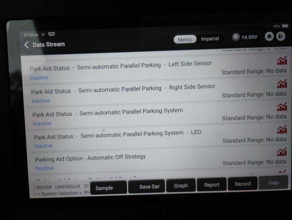

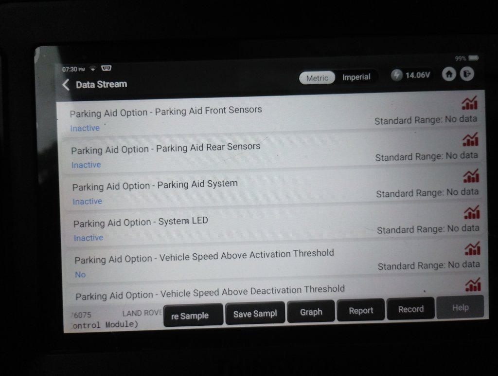

Went around the vehicle with a paper towel tube and took a listen, nothing. I don't think the module is even telling them to activate. I plugged in my fancy generic code reader and read some live values.

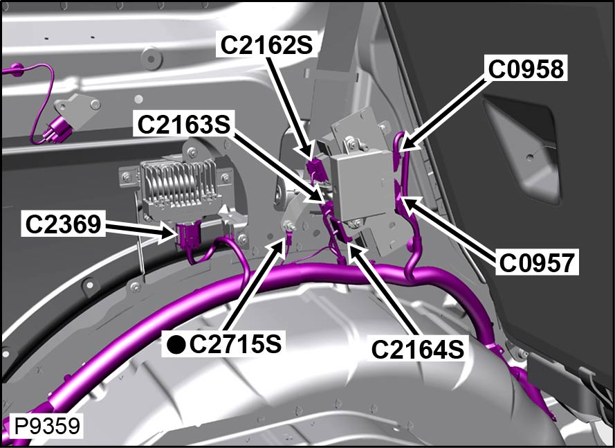

Where is the actual brain bix for this located?

DTC U3000-63 is set when there is a continued park aid sensor failure.
I'm not sure if your scan tool is pulling up all the DTCs.
Park aid module is located in the left side of the cargo area. Right behind the 2nd row seat. C0958 points to it.
