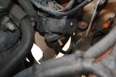

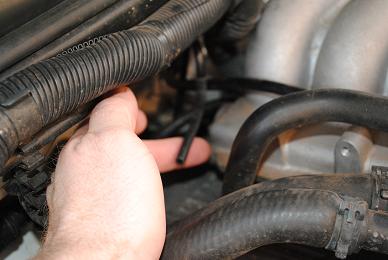

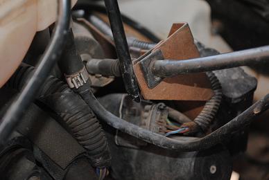

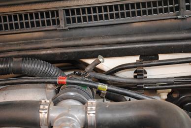

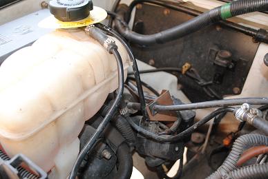

I started checking on why the cruise control does not work on my 99 Disco II. I noticed I have several vacuum lines that are not connected. I am not sure what connects to what. Any ideas? (Hopefully the pictures are attached, this is my first post)

J the Goalie
Apr 16, 2010
btw...I am not the one who cut these lines or put the screw in the t-connector. Just trying to fix my project.

A couple of those pictures from the fire wall are vents from the tranny, picture from passengers side firewall, and front diff, picture from driver side firewall. The coolant bottle picture is of a vent tube and is normal.
If your cruise control light is on then you probably have a vacuum leak at the diaphram which is bolted to the passenger fender behind the coolant bottle, check those hoses as well as the one at the cruise control brake switch on the brake pedal arm. If they are all good then your cruise control ECU may be bad.
