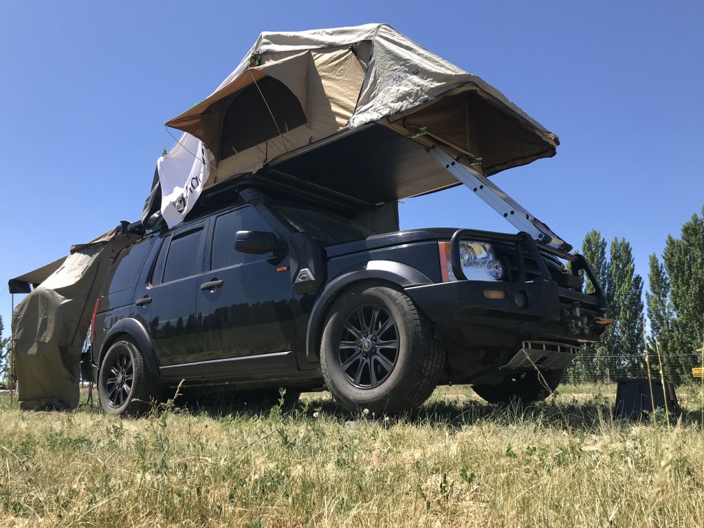

I love it!!! So cool that u made that yourself. Have you dont other such projects in your Landy?

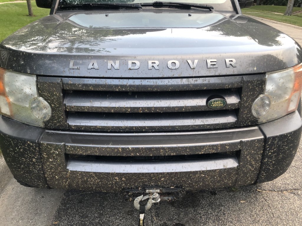

Thanks, I appreciate that. I also installed a harbor freight winch plate hidden in the front bumper. I stole that idea from an LR4 owner who had a pretty good write up on it. Use your favorite search engine to find “lr4 harbor freight winch mount” and you should find it pretty easy. Here’s a pic I took of the front after a trip back to MN. I hate the bugs in the Midwest... I’m buying parts for a dual arm spare tire carrier. I also have some plate steel left over from a work project that I’d like to make a center skid plate, but I haven’t made it very far on that one. I think the thickness of the plate is a little overkill.

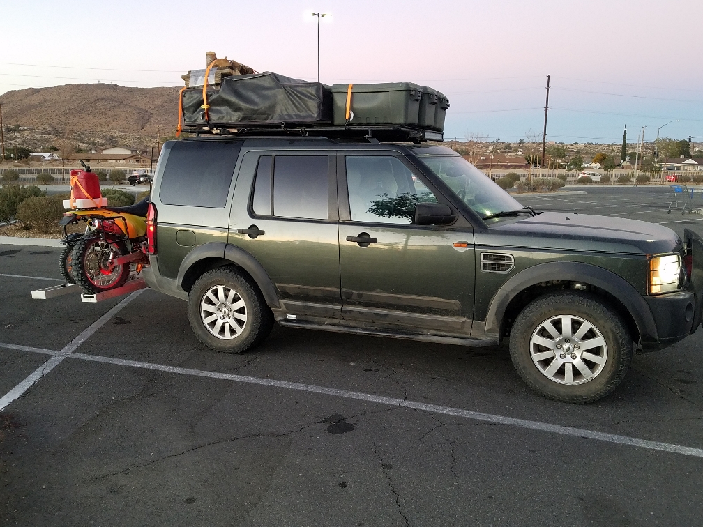

I built my own roof rack about 3 years ago. It was pretty easy, did it in a weekend. Spent about 200 on metal, paint, and a small lightbar. Sorry about the pictures its what i had on my phone. I can take more pictures later if you want me too.

Love the pics. Would love to see close-ups when you get the chance. Mind sharing any tips from the experience of this diy project?

I my case, even if I account for my time, it was still cheaper. Was it worth it to not have a name brand rack? For me, yes. Im guessing not you. I enjoy the fabrication and DIY aspect of it. I guess you could say it’s a hobby to make cool stuff out of cheap/free crap. I’m not all that impressed by all the swanky fully kitted Toyota’s that are in my area. Why? All they did was pick stuff out of a catalog and fire up a credit card. Not much skill in that.

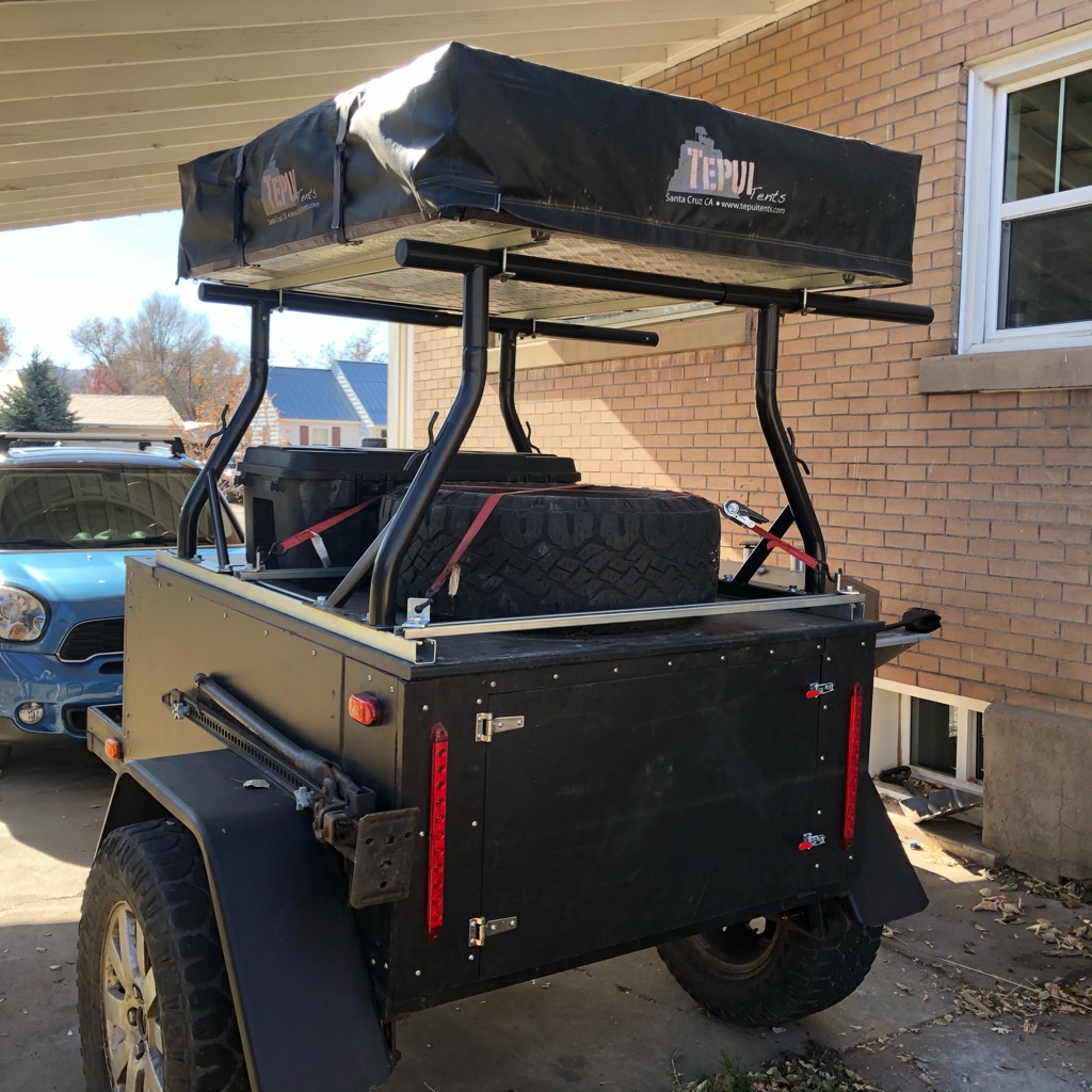

Here’s one of my other “not worth it” projects. Counting the RTT I’ve got about $1200 bucks in parts. What would this cost me if I bought one made? $10k? I don’t have that many hours in it. Plus it’s fun to see people’s reaction when I say I made it out of bathroom stalls!

Bathroom stalls? Hahaha, that's awesome. That's a good looking hauler
