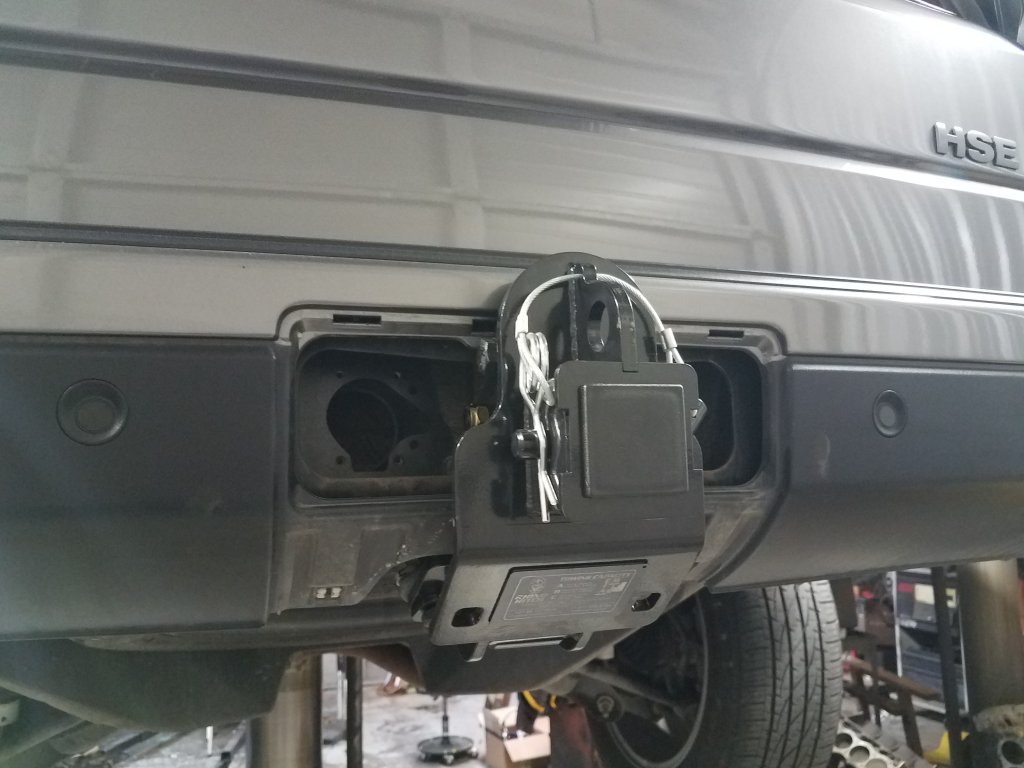

What is the price of the Rhino hitch? It's odd to me that it is not listed on their website and is only available if you know the guy who knows the guy to send a private message. I'm not sure how much I trust a product that is that important if there aren't clearly published details of the design/construction/tested rating.
I just exchanged emails with Todd in March. He's now selling the Rhino hitch via the Snomaster site. Here's a link to the product page on that site: https://www.snomasterusa.com/product-category/parts-accessories/
The price has gone up a little since I bought mine 3 years ago. He has also made a few minor modifications to the current version. However when I asked him if the mods were a fix or an upgrade, he said it was an upgrade and that he is still using his original Rhino on a daily basis on his LR3 with no issues. I don't use mine as often as @mpinco but I am happy with it. It gets admiring looks whenever I'm out with other Rover owners. Everyone loves the mounting height and how it doesn't interfere with departure angle...and protects the rear from those "bump method" parallel parkers.

Do you have a picture of the Rhino
I have quite a few and can take more if you really want a close look at it. Here's a quickie collage of photos I took during its maiden voyage back in 2016:
https://www.instagram.com/p/BF7Dw5DOcrj/
The photos at the snomaster site are mostly of it mounted to a steel bumper, but there's one "*****" shot of it that shows how it fits into the factory slot underneath the stock bumper and then fits to the factory recovery point.

Rhino hitch has worked well for 3+ years towing a TT across the West. No anti-sway or WD hitch.
DonC
Oct 3, 2018
99
63
The Woodlands, TX, US
Here is a pic during the install on mine.
