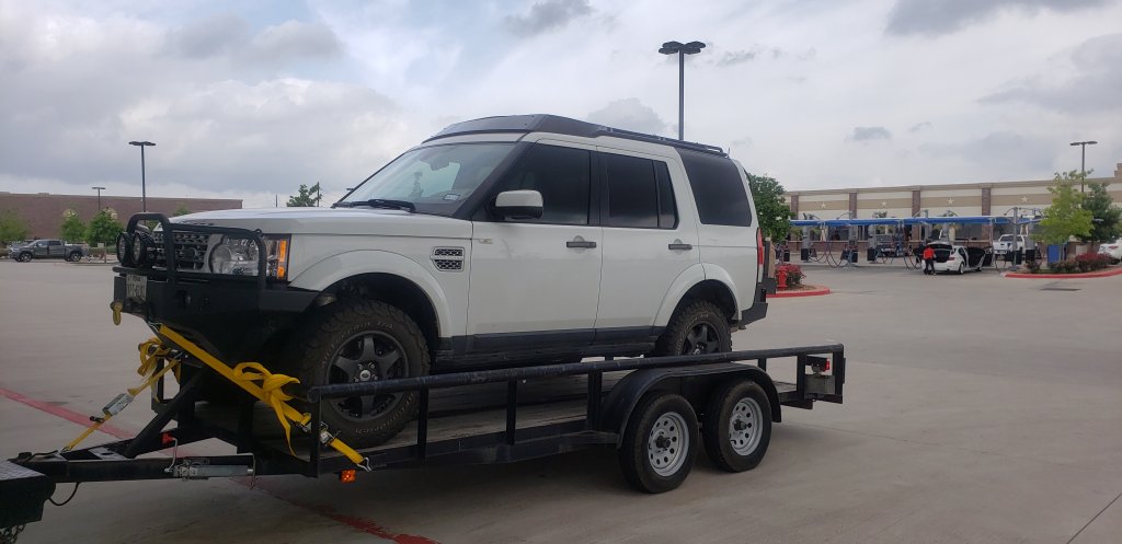

I had to trailer "the goat" about 150 miles today for her last planned mechanical upgrade.
I finally found someone I was comfortable with to install the ARB front locker that has been sitting in my garage since a bit before Hurricane Harvey hit Houston.
I had one dry run to a shop before, only to find out the shims and crush collar required to properly install these are virtually unobtainable. Well, most shops seem to think they are unobtainable, anyway.
A ton of other phone calls revealed most supposed Rover shops don't want to touch this install with a ten foot pole.
If you guys are interested, I will update you with the results in a week or two when I get her back.

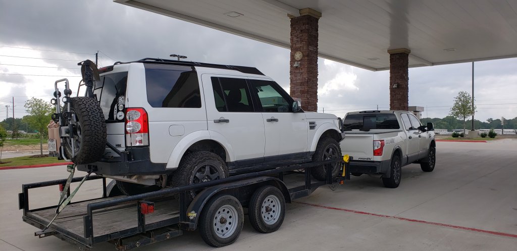

The trailer does have brakes, but I have towed heavier without them, in a pinch. I figure the total load yesterday was somewhere around 9,000 pounds including the weight of the trailer. The trailer has two 5,200 pound rated axles, so wasn't really approaching max weight. The Titan XD Cummins wasn't phased at all by it. Still averaged 14.8mpg, although I didn't go through one of those damned regen cycles that modern diesels have. That would have knocked it down a couple MPG, at least.

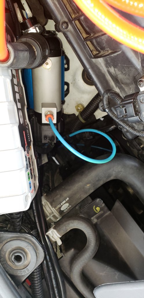

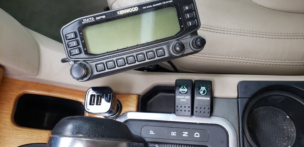

Can't post a pic until I get it back, but yes. There is a switch for air compressor, and a separate switch for the front locker. The compressor switch must be on for the locker to activate. It operates as a bit of a failsafe to prevent unintended activation of the front locker. I would anticipate using it for particularly muddy, sandy, rocky, or snowy sections where one wheel can slip when needed so as not to blow up the front diff. What I have been through before where I know I would have activated it are talus slope climbs or crossings on mountain trails. My rear locker and the terrain response system were asking for a bit of mercy after those.
The compressor itself is mounted under the hood in front of the passenger side air intake housing on top of the fender well.
