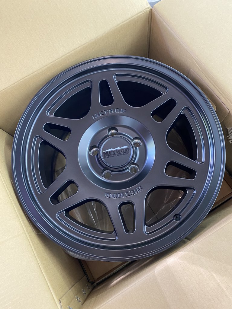

I just got the Method 706's which have been confirmed by Method that they will fit my 2015 LR4. Now for the final decision do I get the 265/65/18 KO2's or 265/60/18 KO2's? I've read everything I can find on the forms and don't want to run a lift if I don't need to. Trying to keep the settings as close to stock as possible while getting the best tire for offroading. I have the Gap Tool. Suggestions?
1,867
You don't need a lift to run the 265/65 tires. In fact, the lift rods are universally a bad idea unless you are also running the SYA kit.
Anyway, the max tire size on a stock-ish LR4 is not affected by the lift; it's affected by the tires hitting the frame horns on a turn, and what you can do if worse comes to worst and the air suspension shoots craps and you drop you the bumpstops.
Without the SYA kit, 265/65 are the biggest you can run and still drive if you are on the bumpstops.
What's the backspacing on those ?
Those are good looking wheels. Like others have mentioned, 265/65/18 are a good size tire, the tallest tire, you can run in stock form. I'd choose that size over 265/60/18.
