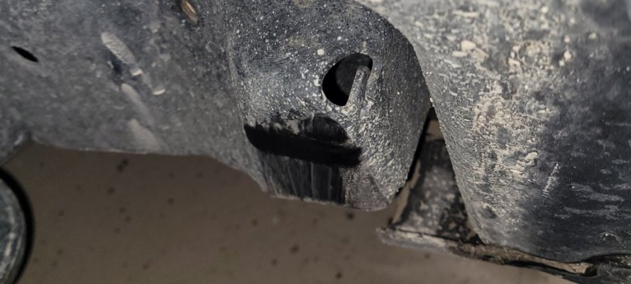

3. They do rub in the front. This was the biggest scare about going to this size, as I didn't know what "rubbing" meant. Am I going to rip my wheel well up? Am I going to tear a fender off? This business was scary, but now that I took the plunge I can report what this means.
Nearly nothing. It only touches in one spot, which is a smooth portion of the frame horn. Attached is a pic taken about 5 minutes ago. Again, 2k on the tires, I just got back from a 2 day, 70 mile off-road excursion with constant full chock/full articulation in the rain, snow, and mud while pulling an overlanding trailer. You can see the dark black stripe where I wiped my finger across it, it's still smooth.
It hasn't even wiped the paint off, and I've been offroad close to 10 times on these tires. I can hear it making a slight "tick" in the cab at full chock from the knobs brushing the frame on this spot, but that's it. I was pondering taking a little metal off to make clearance, but I figure that if its not even getting through the paint, it's fine.
No rub in the back.

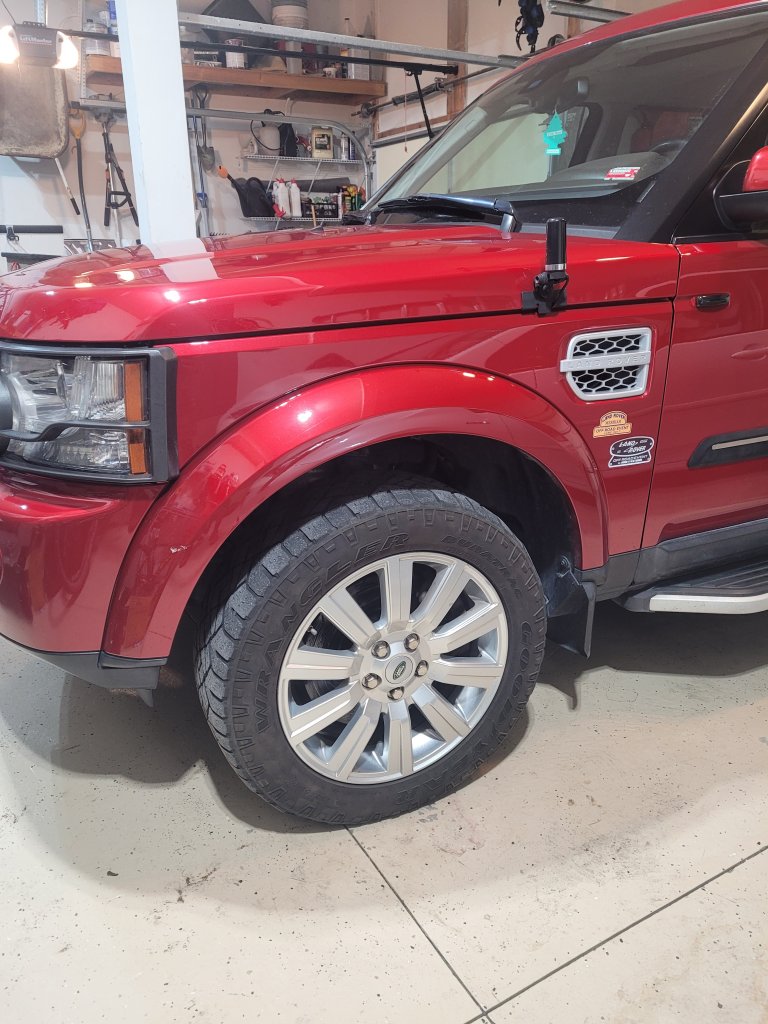

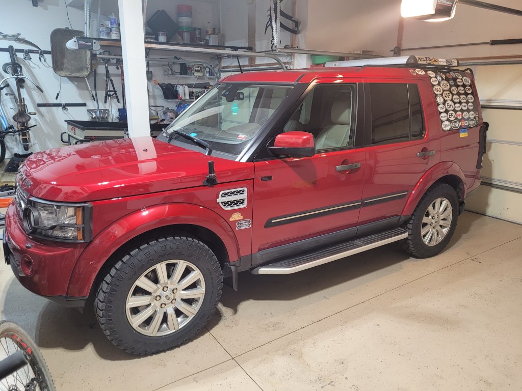

Indeed.
New tires and 1.5" bump (check out that garage door clearance!!):
