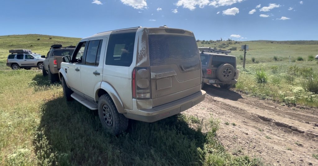

Hi, I have a 2015 LR4, which I wanted to take on Offroad trips. I moved to 18" Tuffant steelies which do not need spacers (they sell 2 versions, one with an offset). I use these with 265/65/18 KO2, and its been a great experience. Great ride, very little rubbing anymore (in the very beginning there was some at full lock). Also, I air them down to about 20 or less when going Offroad, and its been very pleasant.

I second the Defender steelies. If you search craigslist or Facebook marketplace for the steelies off of the new Defender there are some pretty good deals out there. I run the with 265/65/18 KO2s and they fit great, but FYI its a HEAVY setup, like 100lbs per corner. If you don't like white, get them powder coated or something. I ran them with the stock Defender Michelin rubber for a few thousand miles but then tore a sidewall and decided to upgrade. The stock Defender tires are a bit too large anyway, they rub slightly at full lock and rub pretty heavily on the frame horns when articulating off-road. No issues at with the KO2s. I'm super happy with the setup.
If I had 19s I probably wouldn't have switched, there are fewer options for tires, but the selection is still sufficient. My 2016 came with 20s, and that just wouldn't do, and if I was going to switch I thought I might as well go to 18.
