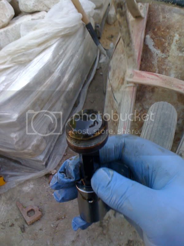

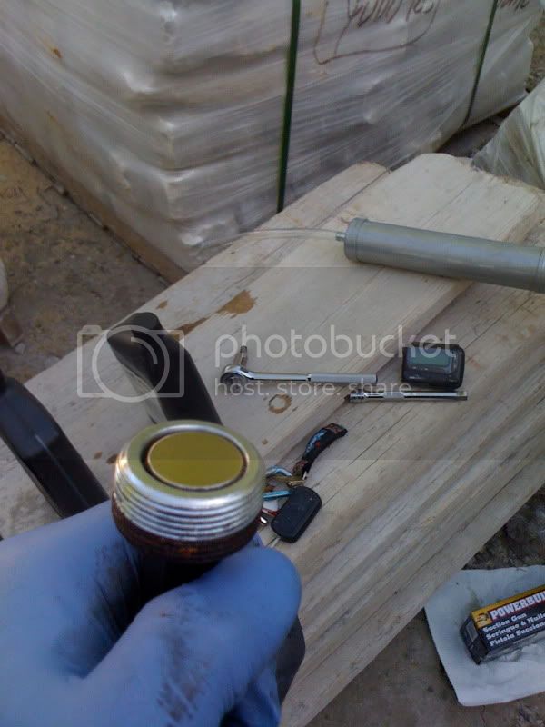

I just changed my diffs since I hit 75K miles. Considering they wanted $600 to do this at the dealership I think I ended up ahead of the game spending $57.00 for 3 liters of saf xo from the dealer and $8.99 for an oil injector from pep boys. here's some pics...
I was surprise at how much junk was stuck to the magnetic drain plugs...
Same part after cleaning...
Word of advice: wear gloves; stuff is nasty and can damage paint.
Easiest to access front diff by cranking wheels to the right...
Use an SUV jack to make sure suspension didn't decide to "adjust"
Done.
