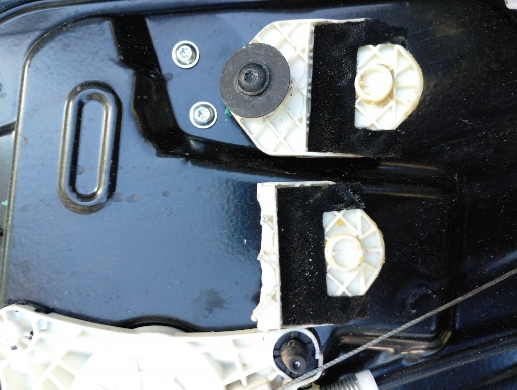

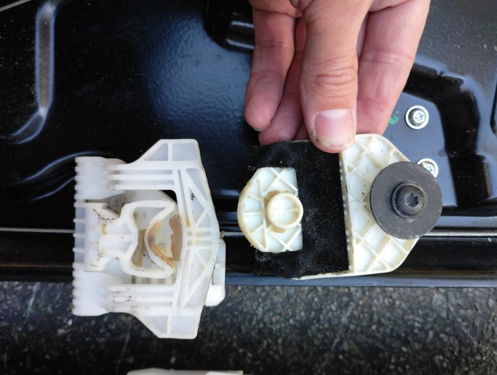

Anyone know the part number for this plastic clip? One of the bolts rattled loose and the remaining clip broke from the strain.
scapistron
Aug 30, 2023
379
266
Massachusetts
Local dealer told me that the clips come with the whole window. I'll be calling a couple of junkyards on Monday. $300 for two plastic clips is nuts.
