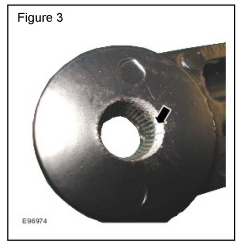

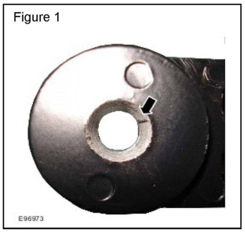

^ Figure 1 is an example of a wiper arm which has been under-tightened. The arm has loosened and the splines of the spindle have worn away the material of the arm.

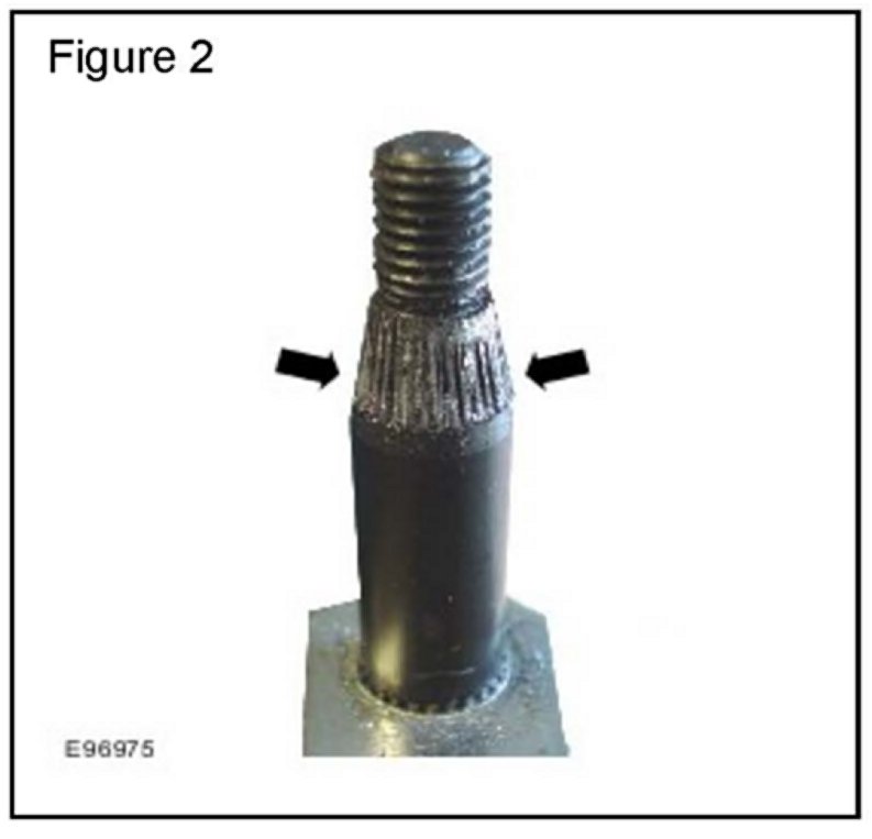

^ Figure 2 is an example of a spindle with a build-up of material from the wiper arm. This material should be cleared using a wire brush.
^ Figure 3 is an example of a wiper arm which has been misaligned on installation. The arm has worn in one area. The resultant wiper performance is affected by the incorrect angle of 'attack' of the blade on the glass, causing a poor wipe, noise and/or judder.
3. If any of the above conditions are found, the other wiper arm head should also be inspected for the same symptoms.
4. Any wiper arms showing evidence of the above conditions should be replaced.
