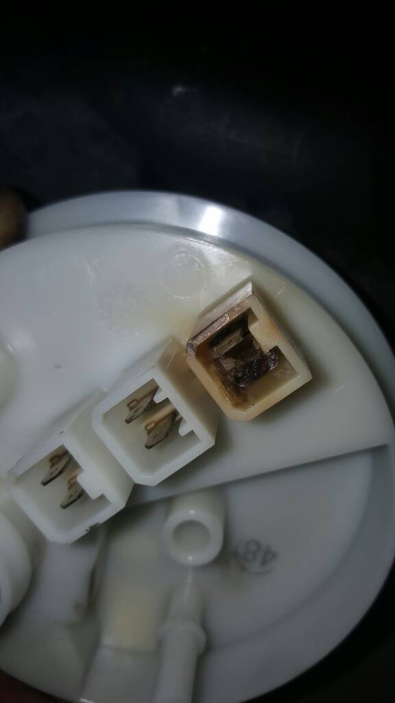

would this capacitor effect the fuel pump? When I turn the car on there is no fuel pressure. Im pretty sure its either the pump or the ECU not telling the pump to turn on. The strange relay behavior makes me think that there is a wiring problem or my ECU is not telling the pump to turn on because its defective or its getting an error on a system that is keeping it from sending the fuel pump on signal.
I came to this conclusion by depressing the valve on the fuel rail and turning the car to on several times and no fuel comes out at all.
Now that I think about it, perhaps the car is out of fuel and the gauge is stuck. Ill try adding some fuel just to rule that out. I kinda doubt this is it because i put my ear to the gas tank and told my wife to turn the car to on and then off a few times and I never heard anything.

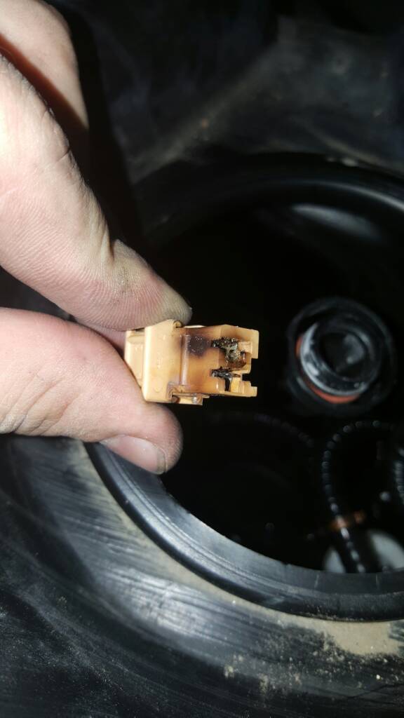

This is a scary find... That wire is inside the tank.

Ok so i cleaned up the contacts really good with sandpaper and electric cleaner then loaded it up with dielectric grease and the car starts and runs great now. Unfortunately the fuel gauge no longer works. Not sure how i messed that up but i did have to remove the float lever taking it in and out hopeully i didnt break it. Not really looking forward to dropping the tank again.
