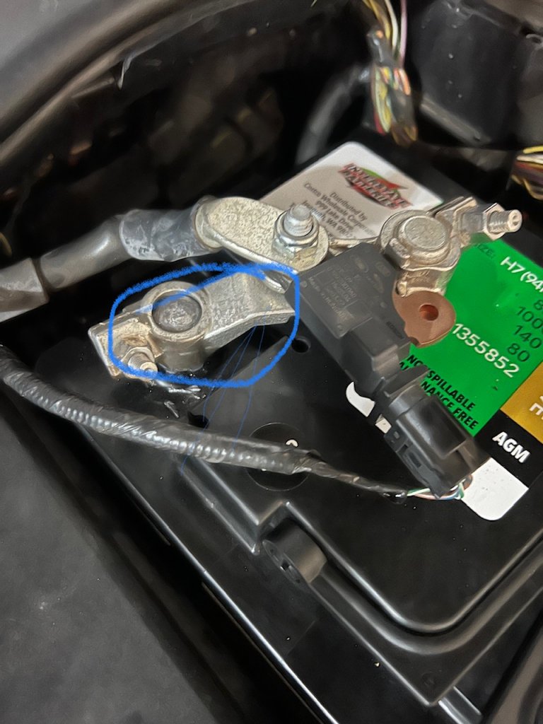

Can anyone tell me the part number of this post extender I cannot get it to tighten? Have found no information on its existence on the web. Thanks
rogers4az
Aug 23, 2021
Not the monitor I'm looking for its the post extender underneath not listed anywhere I found

looks to me like you need to loosen the extender nut, then push the clamp way down on the post so there will be a gap, giving you some space to tighten.

I've had this happen on my 2005 LR3 and 2002 FL1, best way to fix is go to nearest auto parts store, in the battery/battery accessorties section, look for a terminal sleeve that goes over the existing post giving you more "meat" to clamp onto. The sleeve is flexible.
