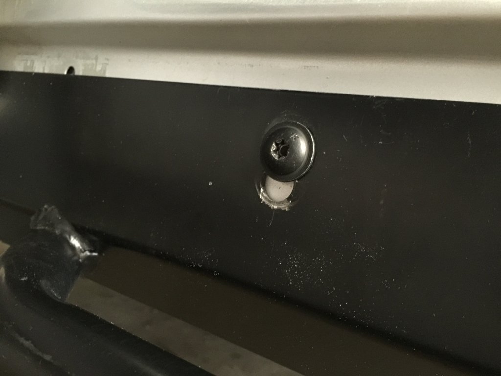

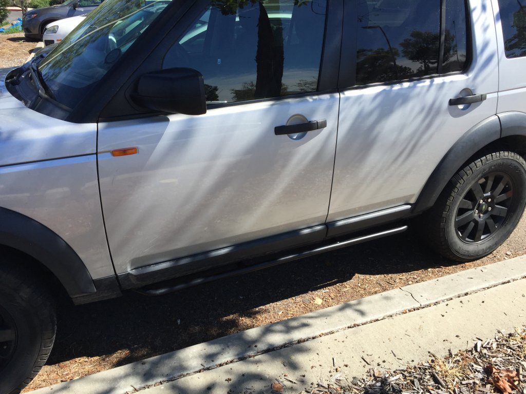

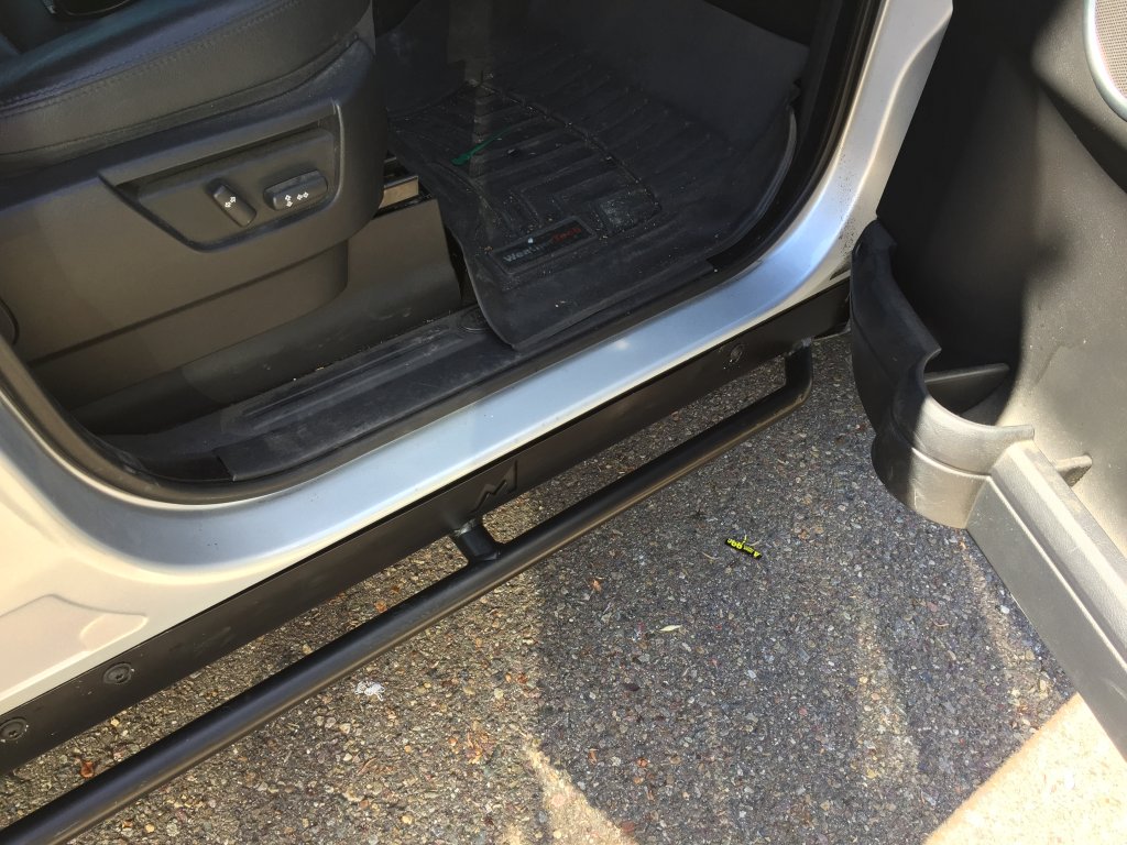

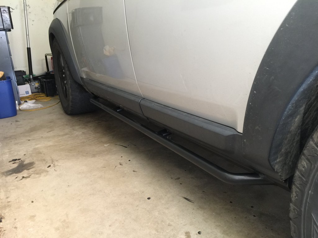

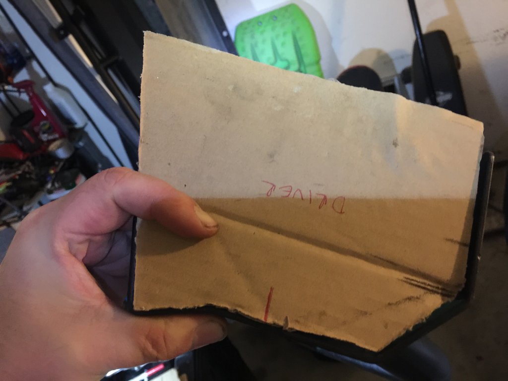

I recently bought the Terrafirma sliders as they were half the price of anything else available and I liked the fact they were only 35lbs a side. In retrospect I should have sent them back for a refund because the fit was absolutely dreadful and I had to elongate all of the holes by about an inch. On top of that, the hardware they came with was completely wrong and I also had to hammer the underside of the rocker panel to get both faces of the slider to fit tight. They were also warped from welding.
I was unaware that the updated ones were made from steel, but the ones I have will do just fine for now.

@anglotron those sliders look nice once they are on, but ya.. sucks to have to modify them like that. And thanks for the fastener part number, that looks like a good option with the wide head.

Damn, sorry to hear about the troubles on the Terrafirma sliders. I was thinking of ordering them, but now I'm not so sure...
