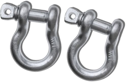

Shackles;
http://www.uscargocontrol.com/anchorshacklescrewpin34steel475ton-p-2465.html
I'm thinking of getting the 3" x 30' 27,000 lbs. strap and two of the
anchor shackles - 3/4" 4.75 Ton.
How does that sound?
The other website said that you measure a shackle's strength with a 5 to 1 ratio?!? Why is that?

The best strap is the 3/4" Yanker by Viking,
However, for our class of vehicle, a 3"x30', 30,000 lbs recovery strap is more typical and ARB makes the best one.
Use 3/4" shackles to secure the strap to the front or rear recovery point on the LR3. A 3/4" shackle has the following strength characteristics (generally):
3/4" Shackle
9,500 lb Working Load Limit
47,500 lb Ultimate Strength
7/8" Pin Diameter
Do NOT use a Winch line, winch line extension, or tree saver as a recovery strap, as these are non-elastic and damage may result. Similarly, don't use a recovery strap in conjunction with winch rigging. Use the proper gear in the proper manner and live to tell about it

If you need a metal bumper with a strong point to hook a D shackle to, then you need to find a safe place to hook the other end of the strap to on the vehicle you want to pull, using the second shackle.
You should never even attempt doing this if you have not been shown/trained by someone who knows all the safe way to do it.
