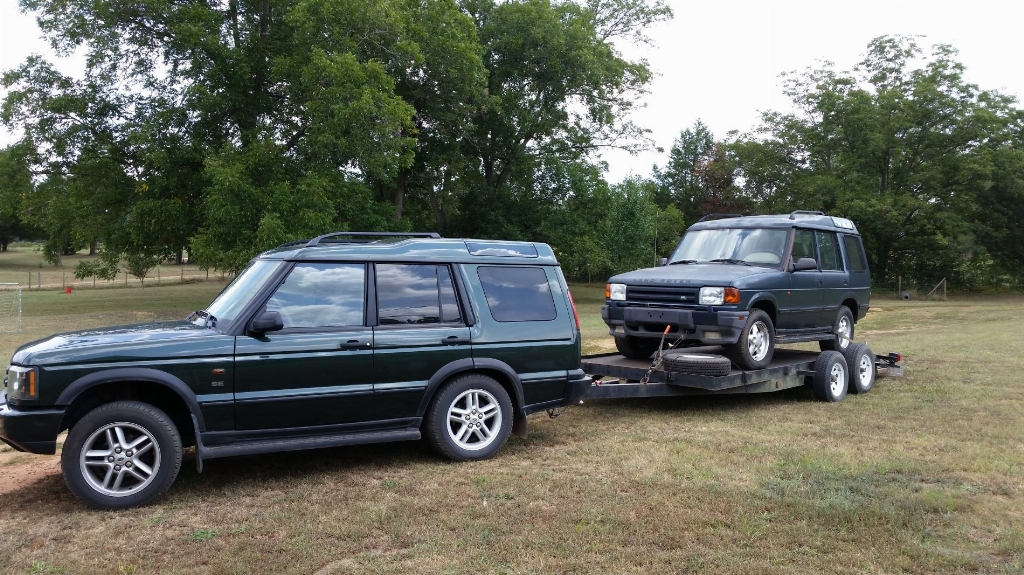

Got a 1996 Disco I with a manual transmission today.
In case any one was wondering about pulling a Disco with a Disco (pulled it home with an '03 DII)...
The '96 Disco was not running when I bought it.
