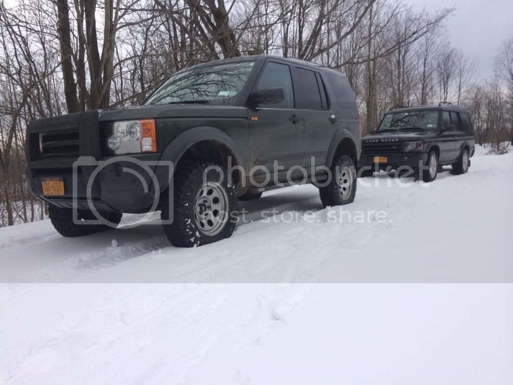

Also, it looks like Lucky 8 may have found a 17" steelie that fits the V8 LR3 without modifications of any kind to the stock brakes:

Brakes still work just as they always have - I really can't tell a difference.
But I would say, don't run the v6 fronts with the v8 rears - I did have to do a panic stop and the rears definitely locked for a second before the computer kicked in and fixed the situation.
The Lucky8 17" steel wheels have a lower offset so you'll get some extra clearance and they fit over the stock v8 brakes. Might solve your issue if the weight limit is high enough on them.

Have you read about the 17" steel wheel provided by mudtech ? I am in conversation with them about wheel options having wider offset, wider rim width and also the 17" they have fitting TDV6 2.7 engine/lr3.
I am not sure yet if they have tested the steel on a V8 lr3 though. It's 17x8 ET 30 but it sounds like it may not work with the v8 brakes.
Also of interest from them are two other wheels:
18"x8.5" alloy ET 45 that will also fit lr4 same as the compo wheel
There's also a 9" wide x 18" ET 20 with optional rock rash ring. It may only fit on the lr3 without spacers though.
These are all tested on their own lr3 and lr4.
My idea would be to use the 17" steel if it will simply bolt on to the lr3 hub without issue. Then test fit the 33" bfg km2 and possibly commit to the lucky8 bump stop limiter. 255/80-17, 10" section. However, your 30.8" size would still provide good ground clearance if using the lucky8 strut top spacers.
Normally I would not want to loose any up travel, but in this design I think you regain enough downward travel to equalize the trade offs.
In reality the limiting thing on tire diameter becomes the fit against the slider ends at both tires. This is where tucking a narrow tire up front is most important. Although, the bfg 305/60x18 would look so incredibly bad ass... You might only be able to go straight ;) or at least revert to steering radius similar to a large tire on a Disco2.
