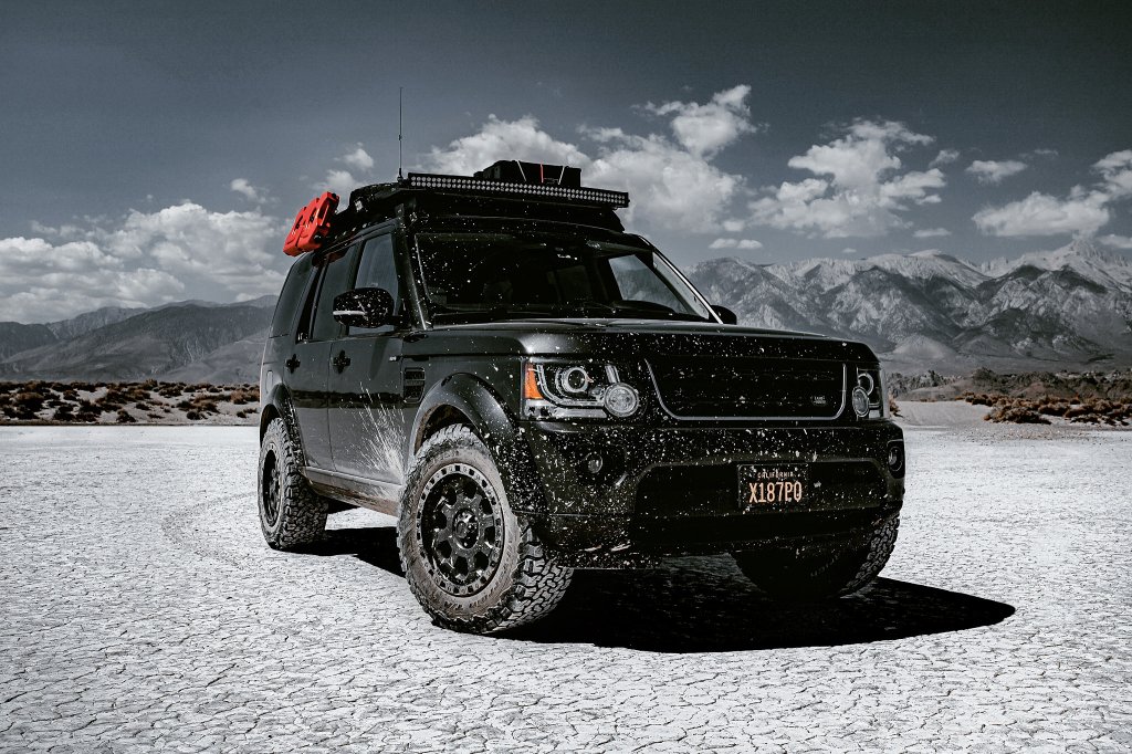

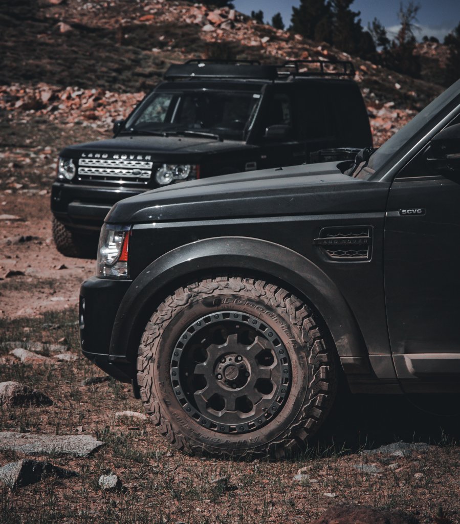

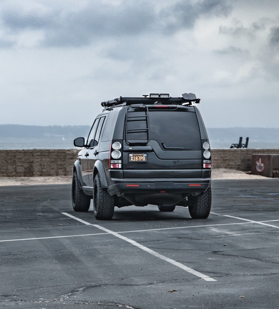

19s have very few tire options. I have a set of 19s in my garage I never mounted because the tire selection was atrocious.
Went with 18s and 275/65/18s all the way around. Been very happy- but these AT tires knock an easy 2MPG off the fuel economy.
I’m very happy with the way it looks and drives, and it’s a very competent setup offroad (I can air down to about 20psi and crawl over sharp rocks no problem).
If this were a daily driver the gas mileage might bug me a bit.
