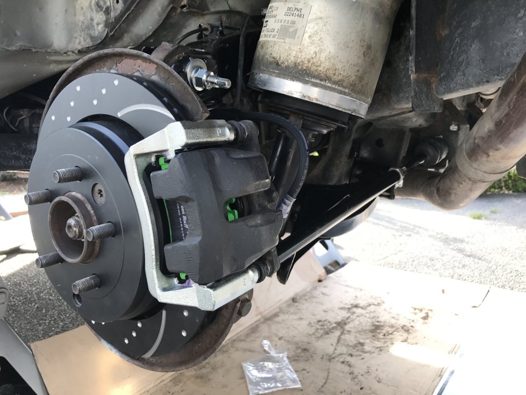

    You guys might be seeing wheels specific to diesels with slightly smaller brakes. It gets very tricky because of the sizing on the same year and body but different engines .

    Sorry man, you're just reading crap that is 'true' but not clear. I have that wheel, it's simply the third 18" wheel to come on lr3's back in 07. The other photo link, I think with the 10 alternating 'flat' spokes, is from then too. None of them work on 'NAS' LR4 or Range Rover or Sport due to our larger brake rotors.
    They do however work on some LR4 tdi builds in ROW builds. From what I've studied, even in TDI builds, the latest LR4 with newer tdi have brakes too big for 17" whereas earlier San use 17"....like I just installed ;)
