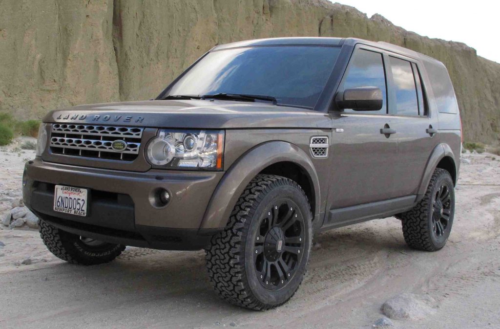

There is a 275/55r20 Duratrac too.
Sent from my SM-G955U using Tapatalk
That’s my current tire. It measures 31.9 new. The MT is slightly larger with the same spec 275/55 size. The duractrac is a passenger tire, not LT and it shows. 20k miles on it, rotated/balanced every 5k. Front left has a bubble and the rest are chewed up and chopped up. Ran at 37psi. Several hundred pounds under at a C load range.

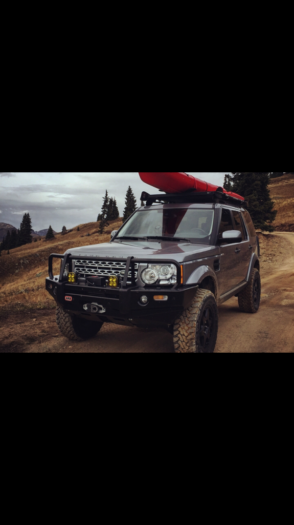

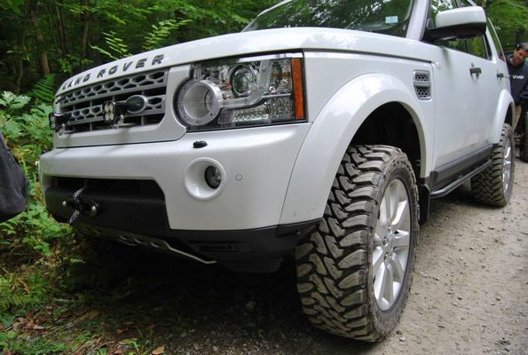

This is a 285/55 KO2 which measures 32.4”. The 275/55 MT’s are 32.1”. The guy who fit 285’s stated in addition to the rod lift he had to cut the frame back some to get a full lock on steering. I don’t imagine much more rub on a 32.1” tire.
In the photo with the canoe on rack shows a 295 size which is just under 34”. They did a gap tool AND rod lift in addition to heavy cutting of wheel wells. Also, there are a few on Instagram who have custom fitted 33” and 35” tires. All depends on how much work you want to do.

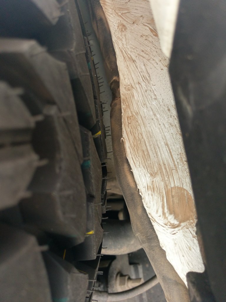

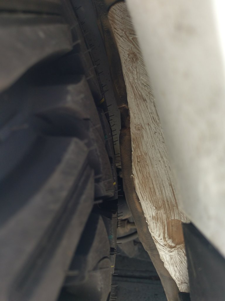

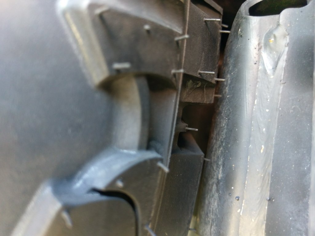

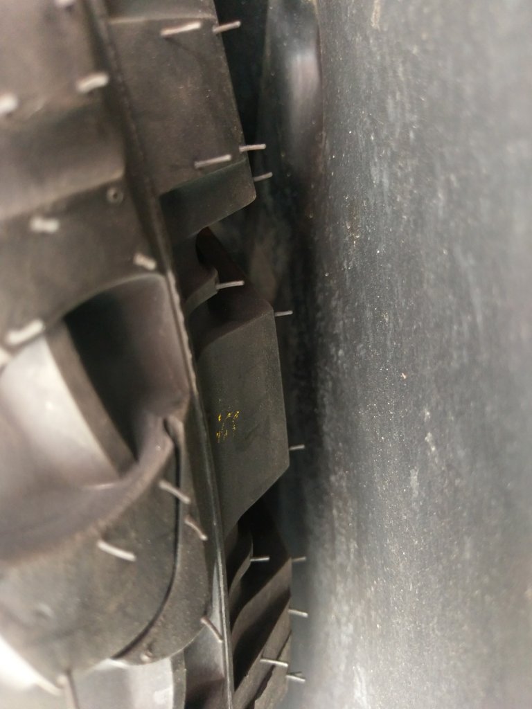

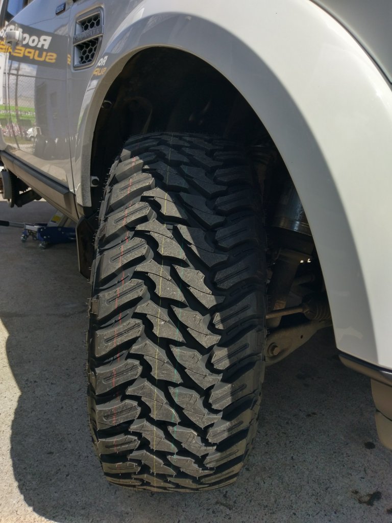

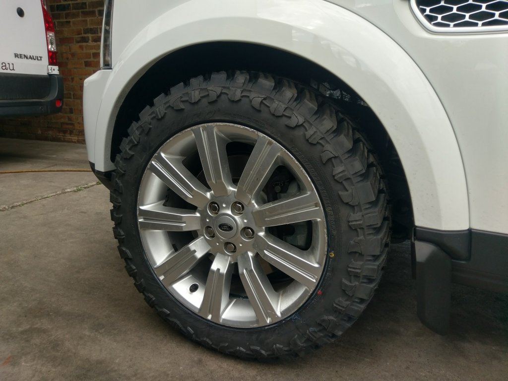

I must say, I was so tempted by the 275/55 but erred on the cautious side. After seeing the clearances I have shown in my photos at very top of post (dropped to the bump stops), there was not much to play with as far as clearances go. Comparing the size 285/50 =793mm and the 275/55=810mm there is a 17mm increase in diameter so halve that and she would be touching. Remember, the photos below are on the bump stops.
Front liner
Now, I know alot of you are running permanent lifts and would say "my car would be clear with 2 inches of lift", but at the end of the day, through full articulation of the wheels when offroading, you will potentially rub when the wheel travels through these areas. So if it touches at the bump stops, you will touch when offroad.
