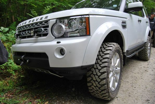

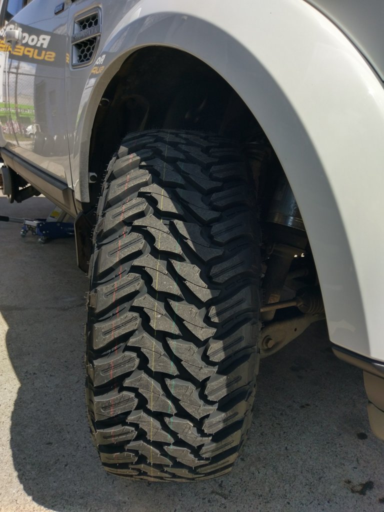

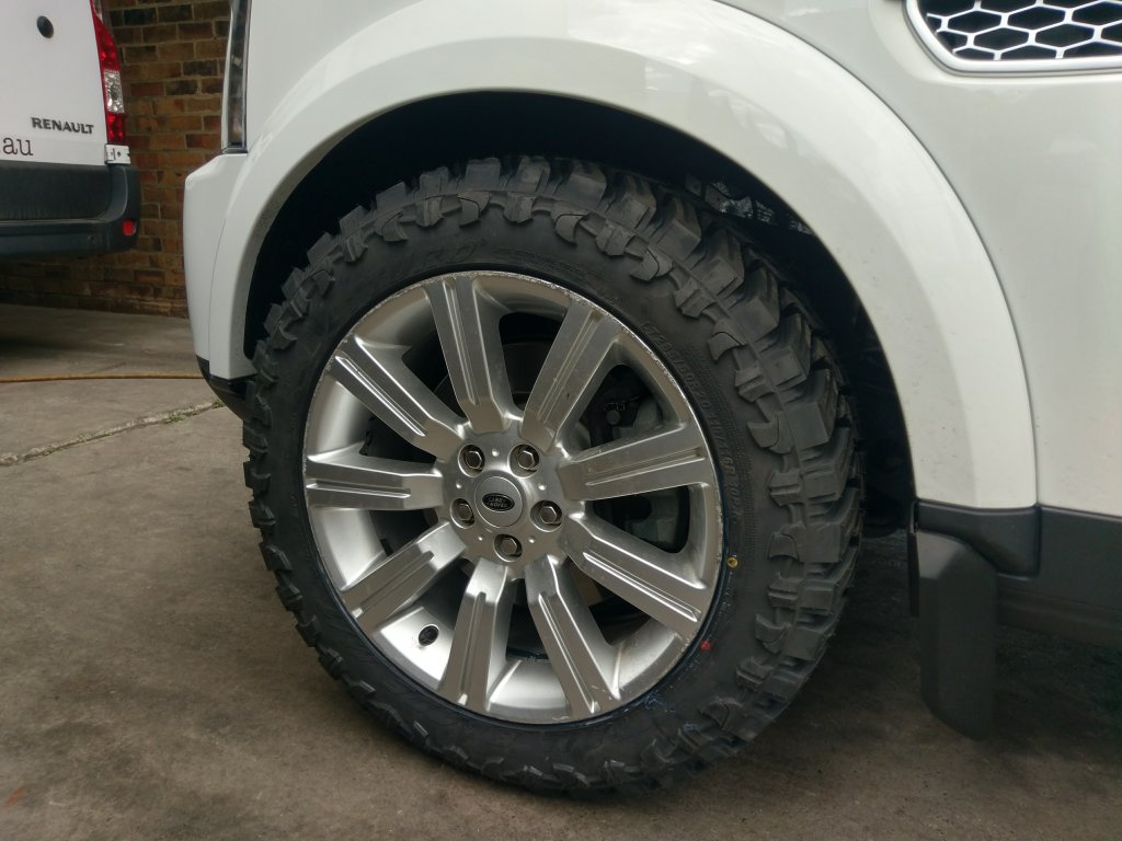

Hi all. As with most others, Discos and tyres have been doing my head in for years. Last Disco tried the GOE wheels with and AT Toyo 2 285/60/18, ok but not as aggressive as I would have liked for a second set of wheels. And on that, the range of 18 inch aggressive, high load tyres that will fit is limited to the BFG.
Current Disco (2015 HSE)has 20s, and while I wasn't happy that it was coming with 20s when purchasing the car, after some research came across a heap of versatile tyres in 265/50/20 and 285/50/20 which several have fitted with great success. When I came across the Atturo in the 285 size with a load rating of 119 I thought I would give them a go. So do they fit?? Yes with success. Dropped it to the bump stops and had only minor rubbing in the right rear front liner, which as you will see from the photos will cause no harm. Everything above this height was clear.
SO, now you can have your second set of mud wheels, with legal wheels, legal size, great load rating for cheap. BTW picked the set of RRS 20 x 9.5 53 offset for $400 on ebay and the tyres were $290 each fitted!! I know everyone that has spent the $$$ on the 18s will say "my sidewall is bigger, and will have a bigger footprint", and yes you are correct, but for the most of us that just want a solid set of aggressive tyres, this ticks the box, and so what if I ding the rims up a bit, I bought them scratched anyway.
And before you ask......yes they are noisier than the standard tyres!!!.....funny that!
