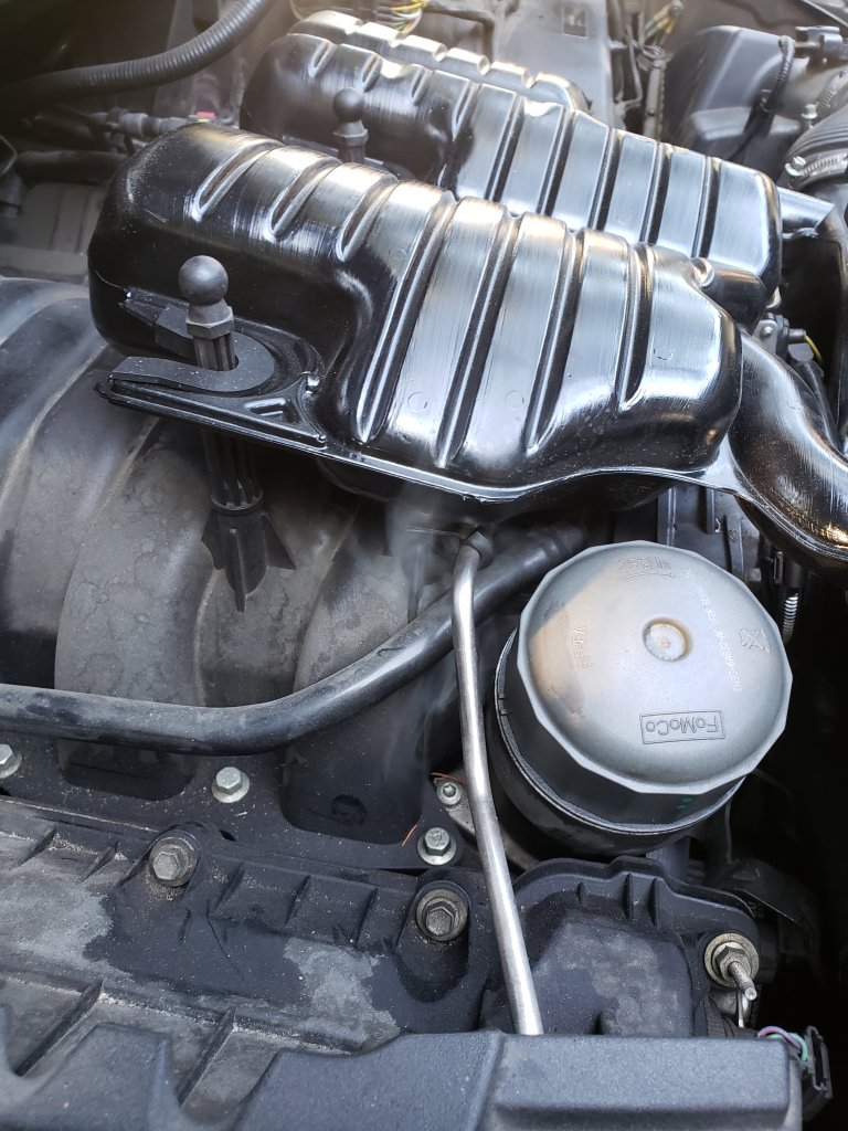

you can barely see the white smoke
coming from behind the coolant pump and below the throttle body

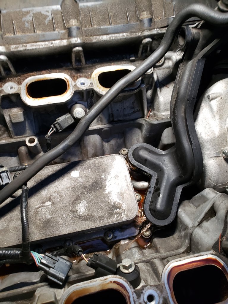

Thanks all, I will let you know how it goes tonight. I'm going to get in there...that said, Matt I think we have a different set up, but I will post pics later...
Sagin
Dec 20, 2016
Los Angeles
Well, here it is! Leak is in a cracked, broken or failed plastic water pump outlet tube thermostat. You can see the orange coolant streaming out after I pressurized the system and removed the intake manifold. I can't believe I am the only one that I found on the web and most LR blogs that had this issue. Well, now to find this part and other hoses that run from the throttle body to under the intake manifold to the back of the engine. Yes, the hose runs from the throttle body and under the intake manifold! The engineer/designer obviously does not work on the cars he designs. That said this hose will be changed for good measure as the manifold is taken apart and exposed (why not).
