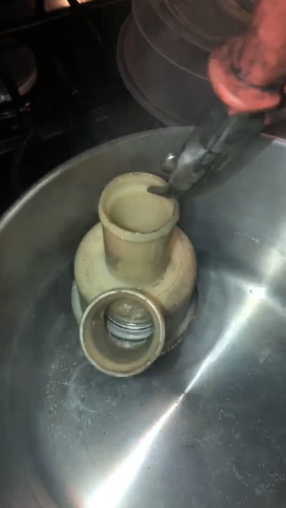

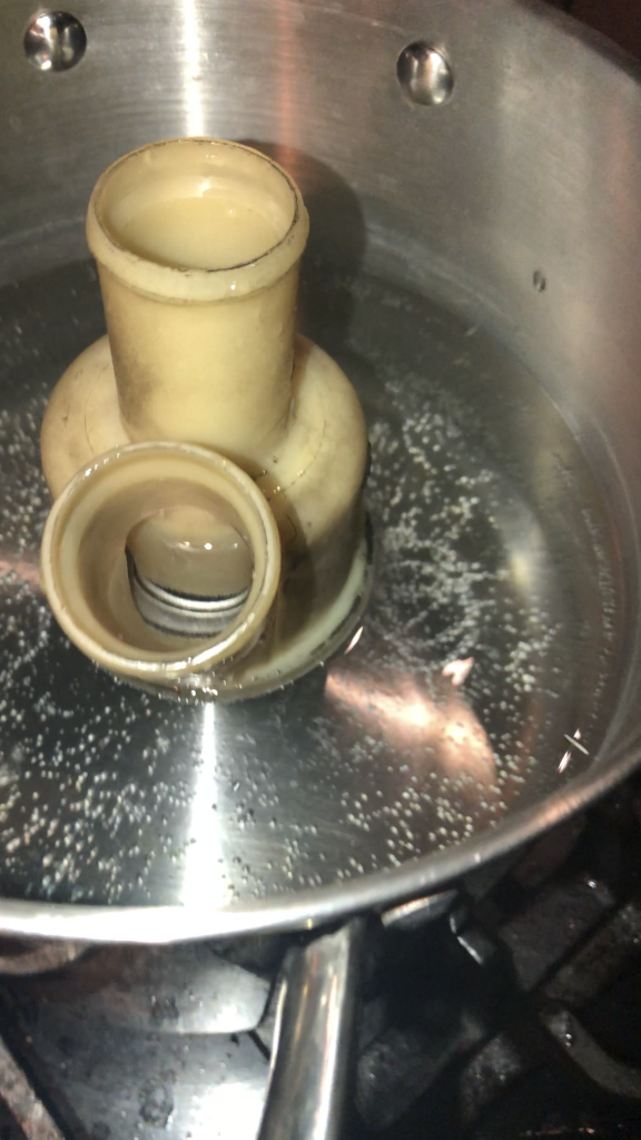

Try checking for the hoses connected to the thermostat if thermostat is opening up and working... I had the same problem with one of my previous D2 and one of my LR3, I bought a bnew thermostat from the dealer but was defective, well not actually defective, probably just needed a break-in...
I boiled the thermostat in water first then install it on the truck, making sure it’s working fine after seeing that it opens up fine and won’t get stuck..
Here’s a video(gif) and photos from the D2 thermostat... observe the water level..
Hope this helps!
