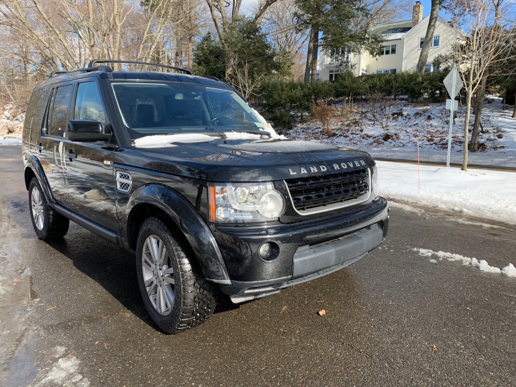

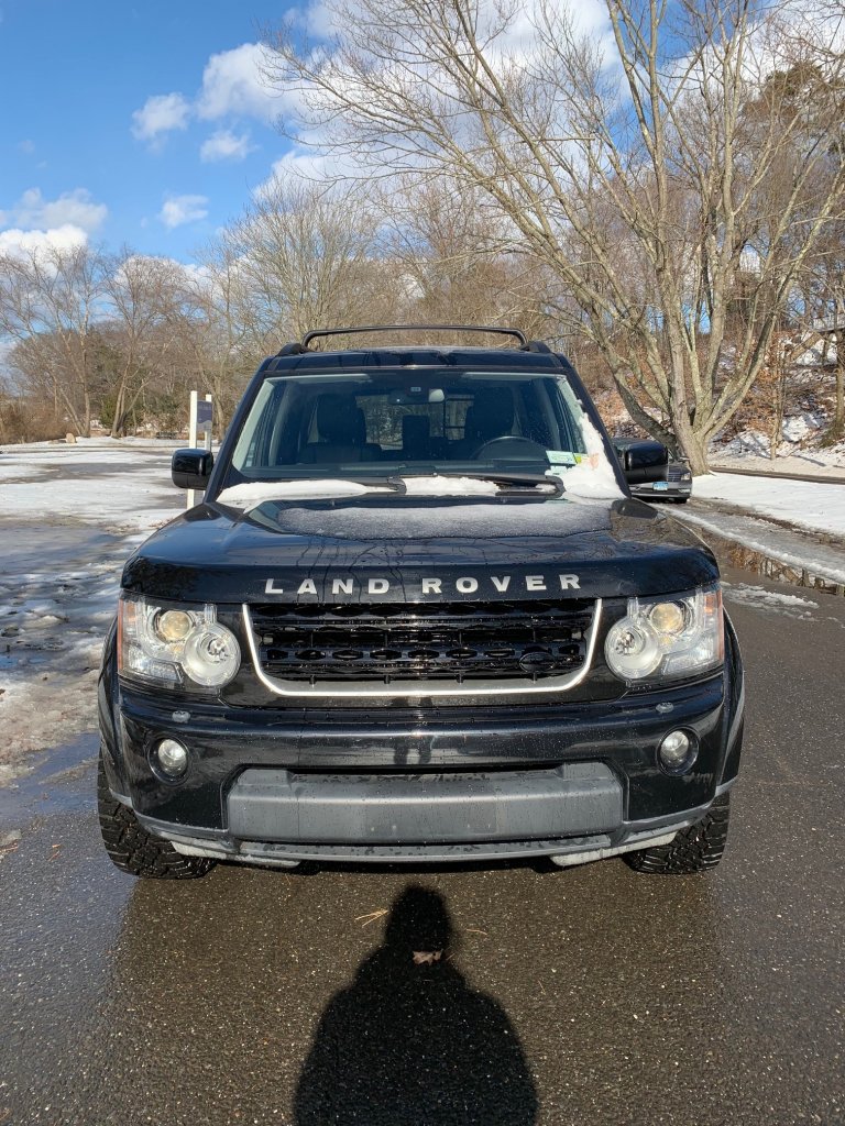

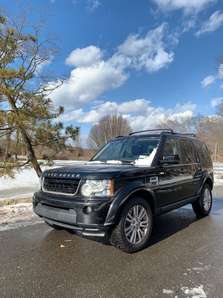

Has anyone purchased and installed the 2014+ "Facelift" style grille (e.g. https://www.powerfuluk.com/vehicles...oks-like-d4-facelift-black-chrome-silver.html) for their LR4?
I'm referring to a grille-only upgrade, not grille + headlight + spacer upgrade kit.
If so, can you post photos? I can't seem to find any examples of the 2010-2013 style headlights with the "Facelift" grille installed, even from those who sell it, oddly enough.
Thanks in advance.
I've got the grille update on my 2011 LR4. I've attached a couple photos below. The trucks dirty and covered in snow, but you can still get the idea.

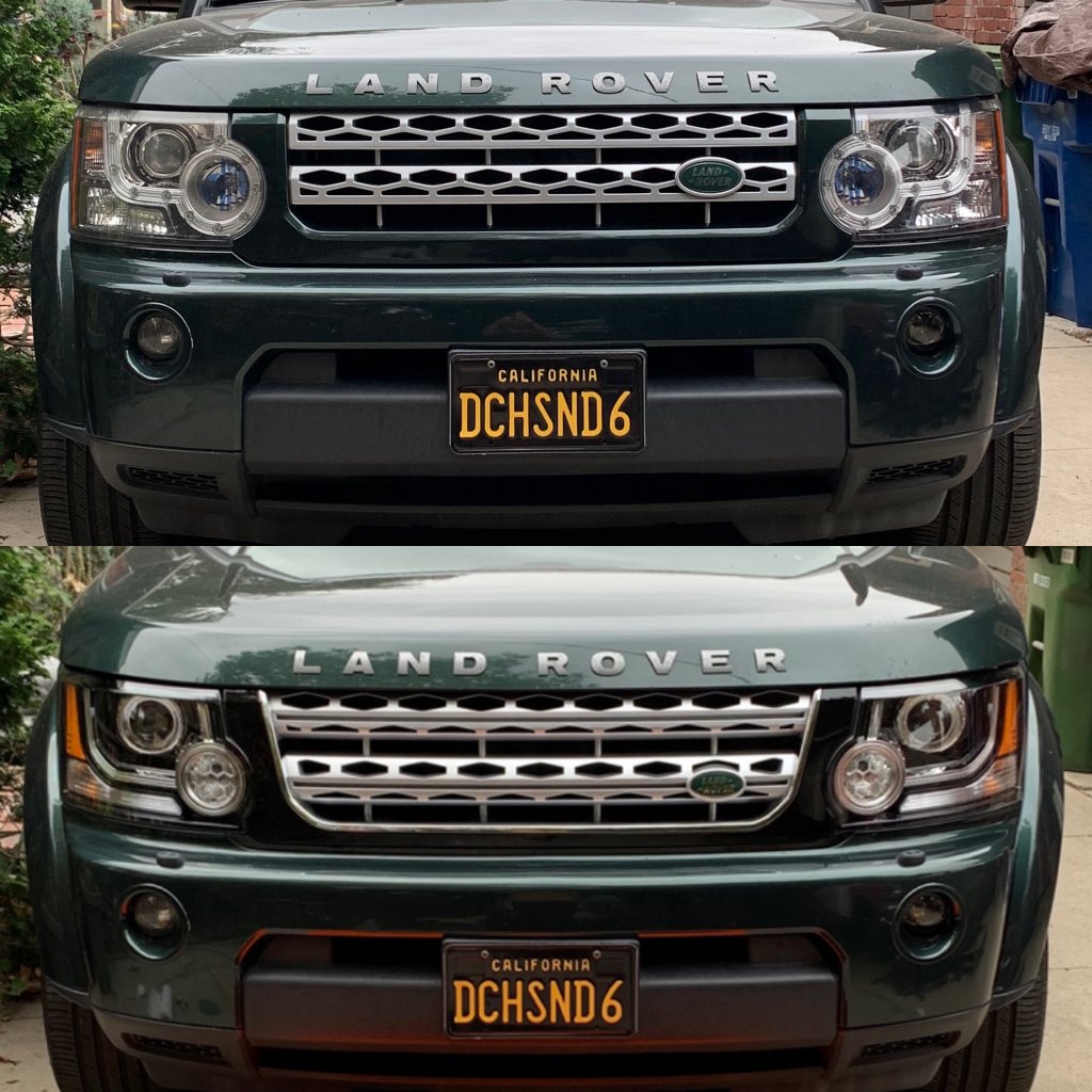

Just did the powerfuluk facelift grill / newer headlamp upgrade on my 2011! Super easy!
