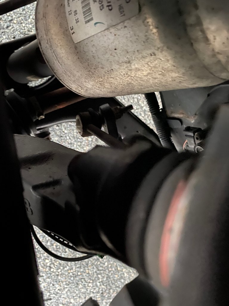

one additional detail i noticed is the strut in the photo is stamped with a 2017 manufacture date, but there is no mention of suspension service in the Carfax. its actually a good thing to know that the suspensions has been at least maintained, and parts replaced as needed.

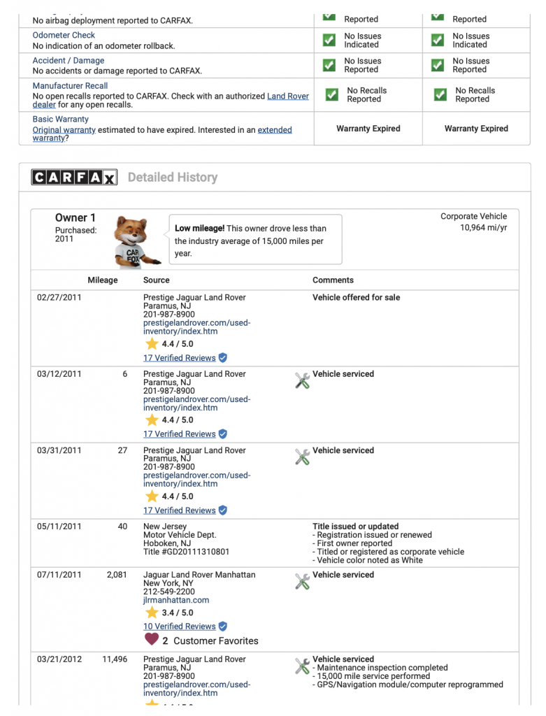

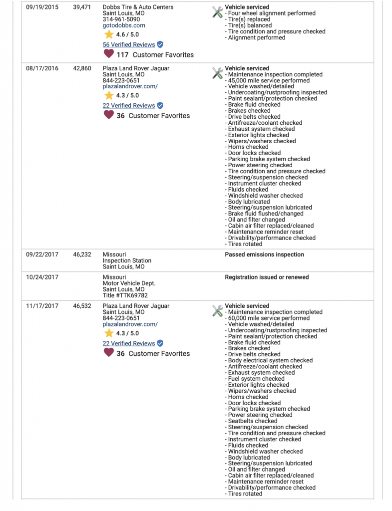

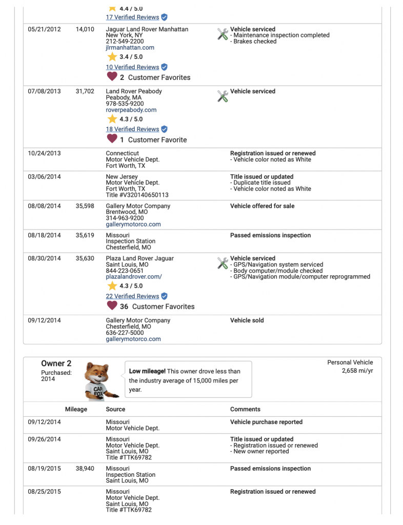

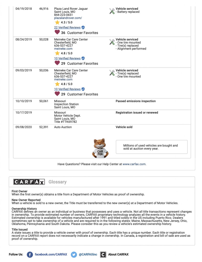

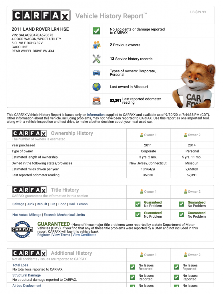

Another Interesting option, also 2011 LR4 5.0 V8, 52k Miles 2own (Corporate & Personal)
Mayor Services made by Rover Dealers.
Possible Good Find? Any feedback much appreciated!

the super low mileage and early maintenance intervals is very nice on this one.
typically i say no to corporate cars, since they are usually not maintained or cared for very well, but this one seems to be an exception.
the only downside is you are in for an expensive service soon, at 75k.
oil change, diff fluid, transfer case fluid, air filters, and most likely water pump failure soon.
this can be about $250 and 4 hours of work in the driveway with proper tools. or probably close to $2000 at the dealer.
Either one of these cars should have the PCV valves replaced and transmission filter/pan changed. the second car due to age and mileage, the 3rd car due to age only.
