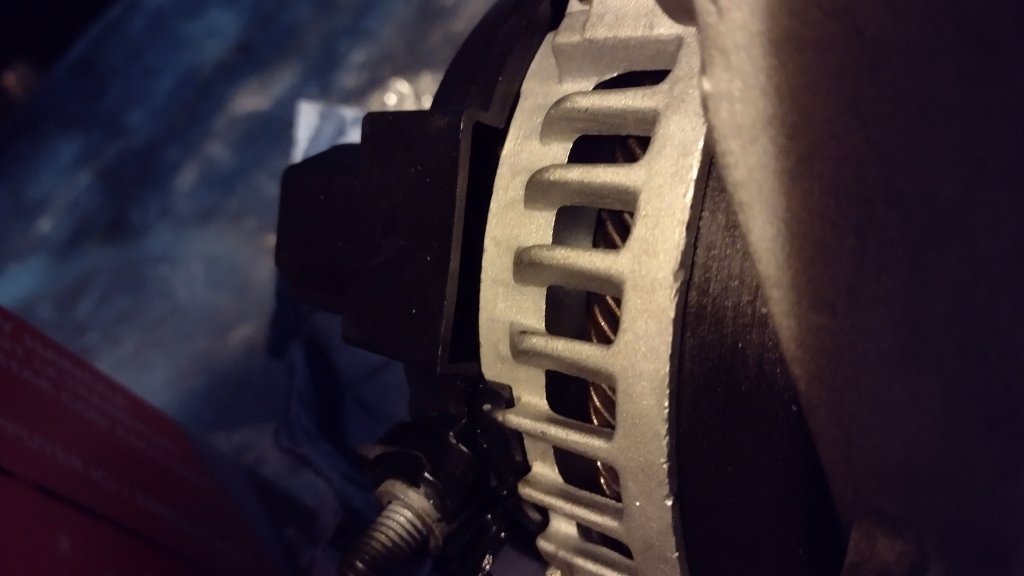

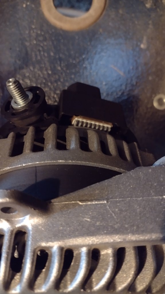

The bad one I got was not regulating correctly. You could visually see the regulator was 1/2 the denso size. Had to peer into the plastic just to see it. Talk to your mechanic, work should be warrantied if only a few months. Ask if you can supply the alternator and get a denso one.

issue has been resolved. it was the alternator i had put in in January. new alternator installed under warranty at no cost to me fixed the surging, pulsing headlights, and relay clicking.
