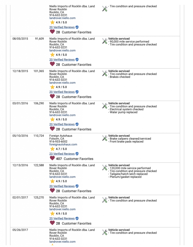

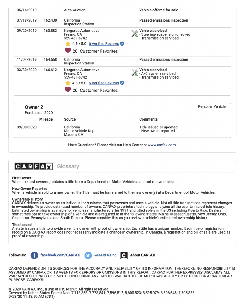

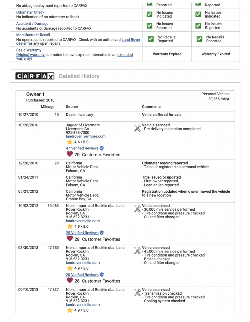

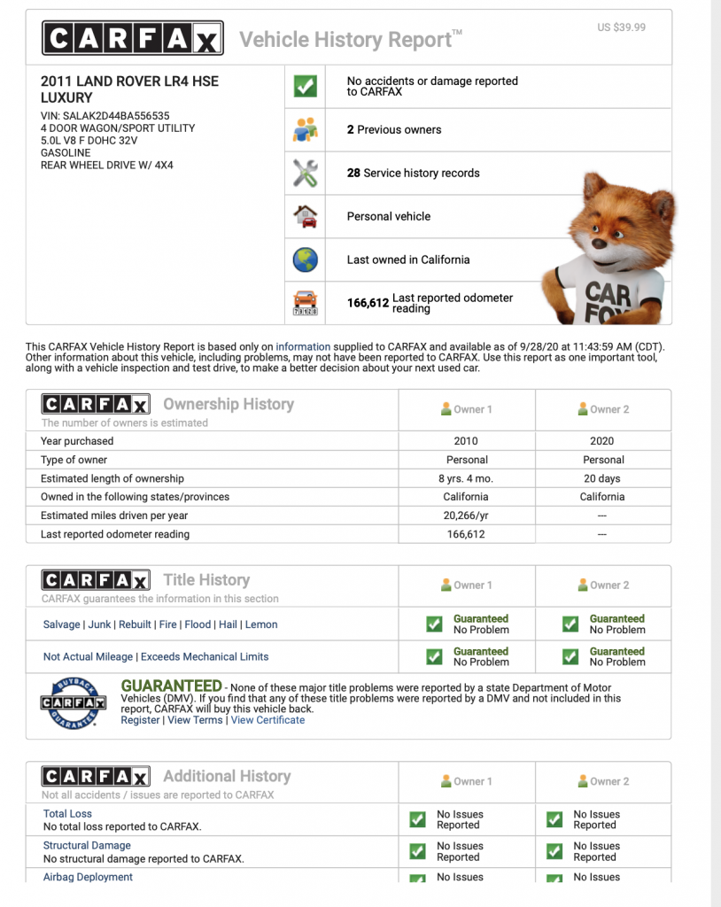

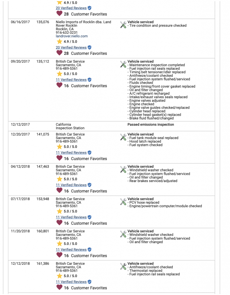

Aside from that, here is the Carfax Report with mantainance records, Please jump in i know you guys have more knowledge in the matter...Looking forward to hear your feedback.

The service history also looks pretty good - they did the major services (30/60/90/120) all within 1-3K miles of the service date.
So...two owners, roughly $20K/yr, almost complete service history at LR dealers - that's pretty good. The service that concerns me is that 135K major rebuild - I'd want to know what happened there. That looks like a major service (timing belt tensioner, gaskets, seals, valve adjustments, valve guides, head?) - If done well...that's probably a good thing.

the good: there was a major failure at 135k miles. seems most likely it was due to timing chain guide failure. at least you wont have to worry about it.
the bad: it only had the oil changed every 15k miles, for its entire life.
besides that, the AC system may have a minor issue. it was serviced (charged) at 135k, and then needed servicing again at 166k, 2.5 years later. Im a believer that AC system should never need charging unless there is a leak. then again, a refill needed every 2.5 years may be worth the money VS cost of repair.

Wow..... major incident due to the chain being out of time. looks like they fixed it all properly since it did 20k after that, but I'd be curious to see what the marks on the pistons look like from hitting the cylinder heads and valves.
