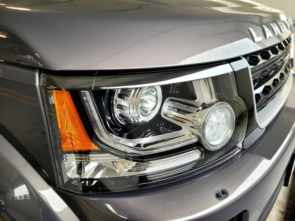

Agreed. The Sylvania kit is the only one that will get pro-level results with a little modification. After the initial sanding steps, a final machine polish with a polishing compound (e.g. KochChemie Fine Cut) will clarify any micro scratches down to 2500 grit - this should get you perfect clarity before the final UV coat. Would also suggest a ceramic UV coating (like Dr Beazleys Headlight Coating) after a week or two of curing.
Here's how mine turned out...
