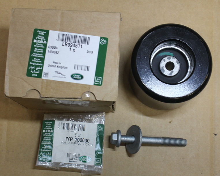

I got the parts too but haven't installed yet. The damper is surprisingly heavy, a good 7lbs or so. Haven't looked to see if the vacant hole is threaded or not.

Got mine from Land Rover Merriam parts, I want to say it was just over $50 for the damper and bolt. They were better priced than the dealer as well....

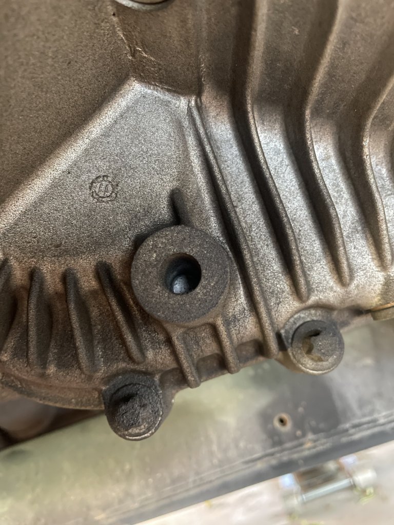

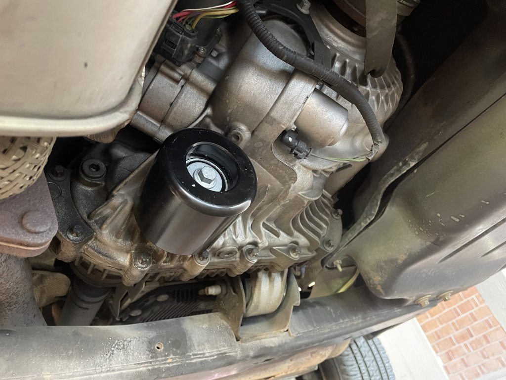

Just finished installing the damper. It took about 20 minutes.
Here is the untapped hole. TSB says it’s tapped… it’s not!

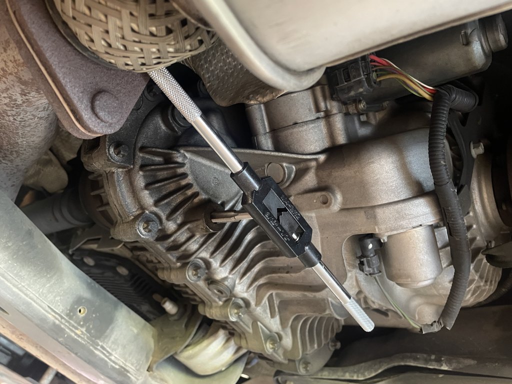

This looks to be the right size:
Wait, I can’t turn it…

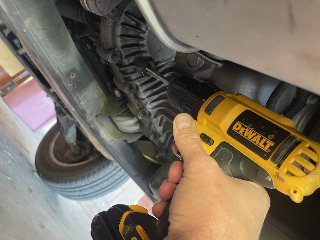

How about a drill?

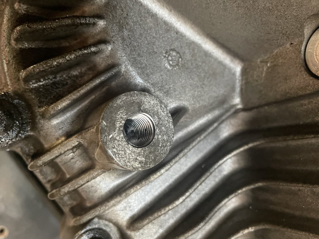

I tapped that hole like it’s never been tapped before.
Mmmm shiny threads.

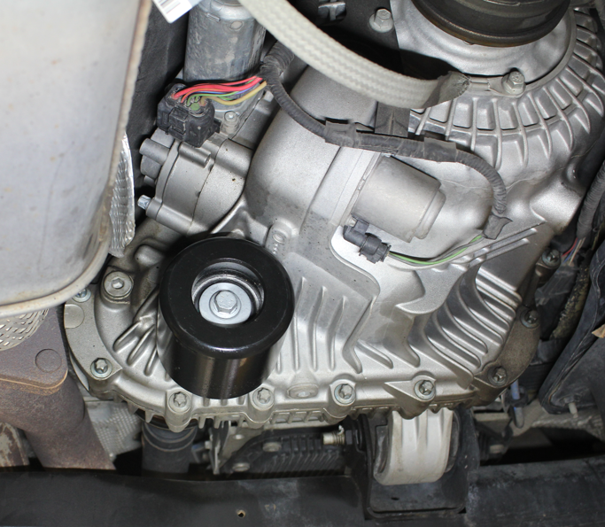

Done!!
Now I did have a slight issue. The TSB says to torque to 55.5 lb/ft. I got to about 40 when it became a whole lot easier to tighten the bolt. I backed it out and confirmed that I stripped the holes a bit. I didn’t remove any of the damaged threads, rather just put the bolt back in and tightened until it was good enough. It seems pretty tight but I will keep my eye on it to see if backs out any. I really don’t want to drill it out and install a helicoil but I guess that’s plan B if this doesn’t hold.
I went for a drive and I do confirm that this fixes the vibration by about 80-90%. Enough so that you would not notice it if you didn’t know it was there.
10/10 would do it again!
