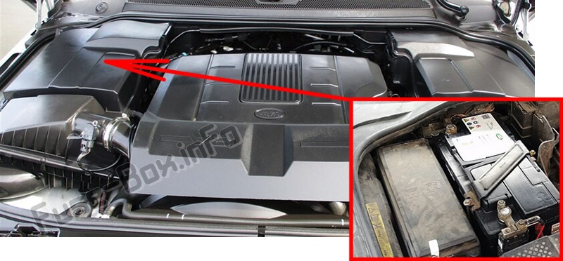

Hello SMorelli. Would you mind sharing a pic of the location of the relay. I have an intermittent issue with my 16LR4
SMorelli
Sep 15, 2023
19
Canada
The relay is in the long narrow fuse box next to the battery. I believe it is R8 for the fuel pump controller. Is is the same type of relay as the AC relay so if you swap them you can prove if that’s your issue.
The lid of the fuse box is labeled so easy to follow.
Let us know if this was your issue!
