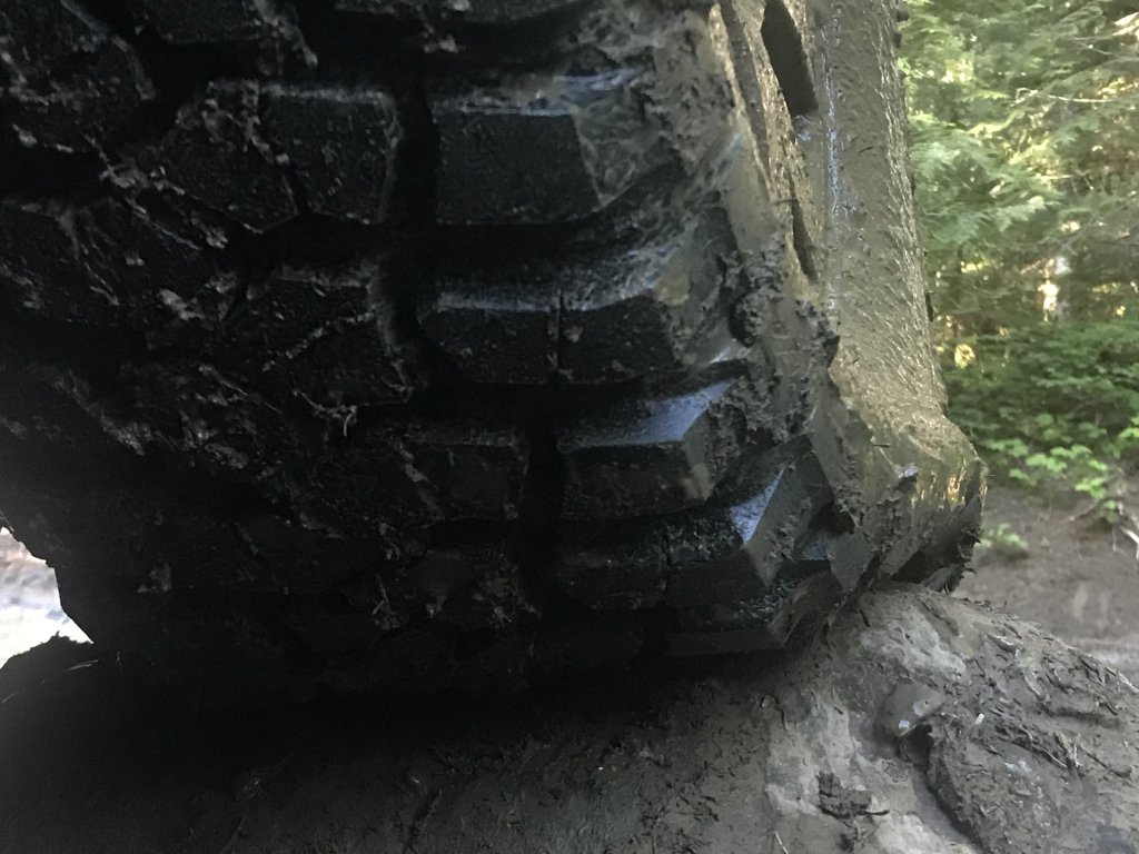

You can't let enough air out for good traction. With a fully inflated tire, you have no where near the traction of a tire at 20 psi. It's night and day different. A deflated tire can 'wrap' over objects which not only provides over 50% more contact area of the tread to surface/object, but that also allows the tire to deform away from dangerous objects that can cause a puncture.
Consider the amount of force a basic balloon requires to pop against a knife point. A super tight balloon can simply drift in the air onto the point and pop. No pressure at all really, hard to even feel. However, take a balloon with almost no air, in your hand, press on knife. It's actually going to take some intentional pressure to break the rubber material. Kind of like your hand if it's moving quickly vs gentle pressure. For either, a lot more pressure is endured before puncture. Pretty much the same on tires and sharp stuff off road.
So the soft tire wins huge on traction and puncture resistance but there's more...

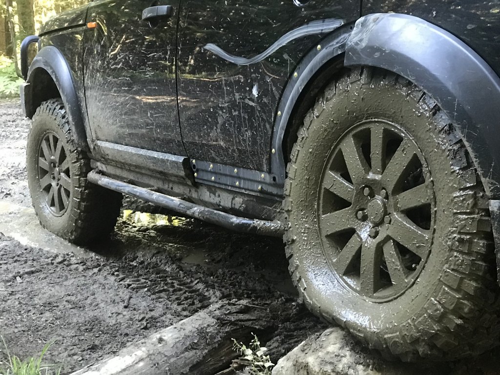

The ride is **** for hours at 40-45 psi. The ride is like a freakin magic carpet dream at 20 psi. This is nice for sure but it also allows the tire to become an active part of the suspension, not just an extension of the rigid wheel.
The added deflection in a soft tire, plus more sidewall, actually starts to appreciably increase the effective articulation of the suspension and overall range of 4 tire traction. This is because on the same obstacle, a stiff inflated tired vehicle will left tires off the ground, like a diagonal situation, a lot sooner than mine will with a full inch more sidewall plus 2-3" of actual tire deformation. The two tires that deform so much allow the other 2 to stay in contact and therefor help drive through the spot.

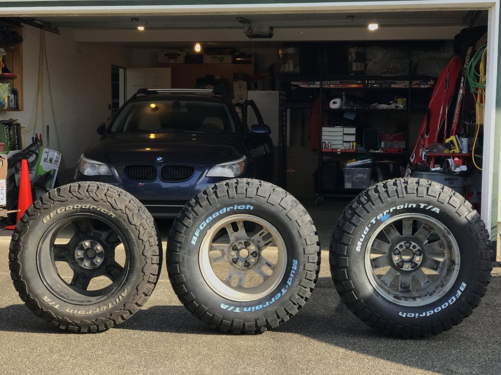

So that totally sounds like a BFG ko2 plan but the 18's will allow you to have no worries at all when you want to take the 'long' cut through some CO high divide crossing trail instead of the interstate. I've been on trips from Seattle to DC and in between ended up deciding to spend the night on the divide on a route that would've been really sketchy on 20's, Yet I had no worries with a proper tire set up. Part of the equation with some of these is the E load range is also a lot more durable off road and designed to handle long drives at low psi.
Those Mudtech wheels look badass to be honest. I have never liked designs that don't follow the 5 factor in the spokes/holes. Meaning, I don't like the compos odd number whereas the Mudtech are 10 spokes as are many of rover factory wheels.
