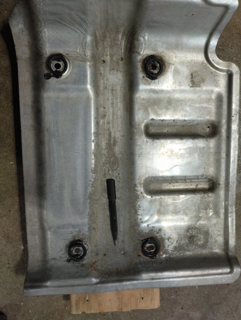

I punched a few drain holes in the heat shield so it would stop collecting condensate. Also put a couple dabs of RTV on the o-rings to hold them in place to make reassembly easier.

I didn't use rtv on the transmission, just on the o-ring isolators on the heat shield as glue.
