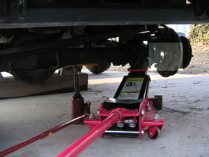

The 245's do not rub that much more than the 265's. You loose a little more turning radius, but that is all. I really like everything about the 265's but that is just a personal opinion. Here is a picture of the bolt that you have to adjust. It is not a great shot, but you will see it when you look under the vehicle...:biggrin:

Hey thanks Slam.. I was geting info from this site > http://www.rangerovers.net/rrtires.html
They did say that the 245/75/16s fit on stock classics but must adjust the steering stops.. I'm ordering my tires from tire rack tomorrow hehe I got someone to buy my stock Michilins for 60 bucks a pop.. COOLIO !
