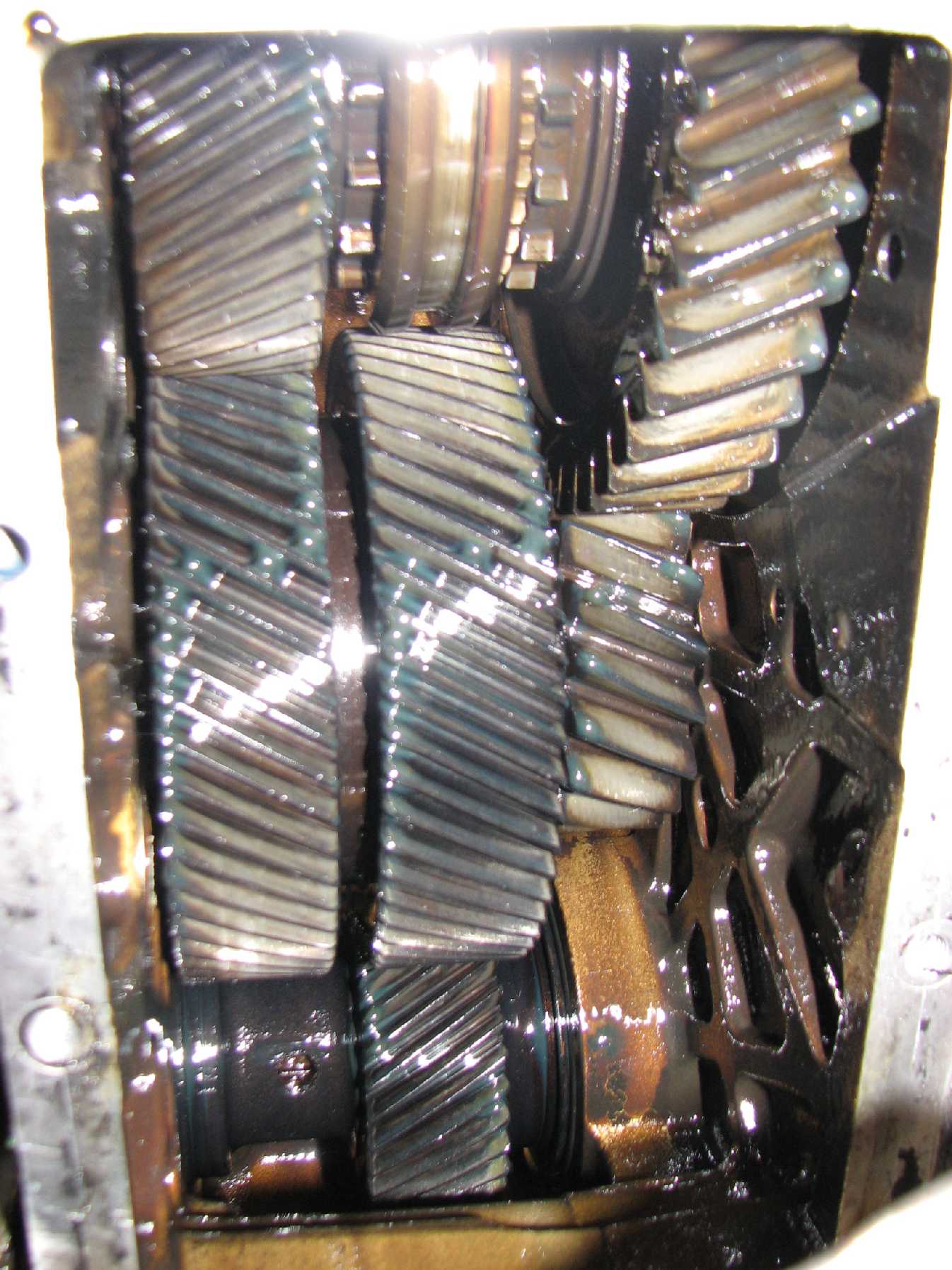

More troubleshooting: I drained the transfer case and took off the large access plate. Pic attached for the curious. Nothing of significance to note there, at least nothing I could see. Reinstalled the plate and refilled with 85/140 gear lube ... no change in the noise though. It seems to be noisiest in low with the CDL engaged, a little quieter (emphasis on "little") in high with the CDL dis-engaged. No problem shifting gears or engaging the diff lock, btw ... everything there works smoothly.
I put the front wheels up on jackstands, dropped the rear drive shaft, and removed the emergency brake drum. There's no oil leakage and no significant play in either of the driveshafts. With the transmission in neutral and gear box in high, CDL dis-engaged, I can hear a little noise when rotating the rear output flange by hand. I'm not experienced enough with these to know if that's normal or not, though my guess would be "not." I'll try the same check with the front driveshaft down also. Dumb question first: with the transfer case in neutral are the intermediate gears disengaged? If I can isolate the noise to the front or rear main bearings by disengaging everything else in the drive train, I might be able to get away with replacing them in place vs pulling the whole transfer case.

Is that fluid blue, if so what are you running in it?
Tim Wilson
Jun 9, 2009
That's Castrol 80/90, contaminated with the residual black stuff that was left when I drained and refilled the transfer case.
