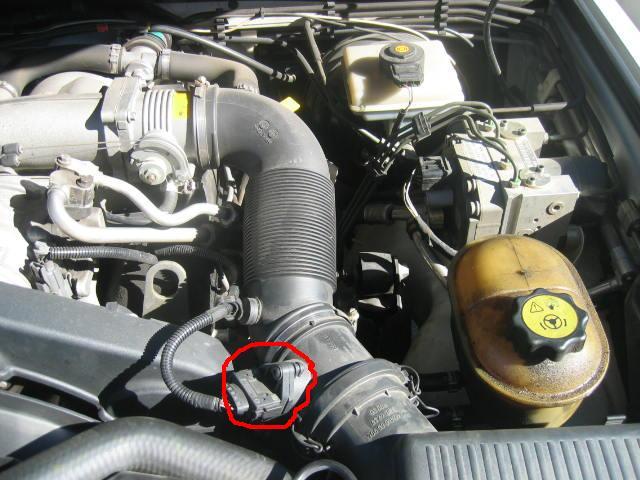

The Maf sensor is that piece between the air filter housing and the air intake tube, if you look at you picture you will see a wire harness plugged into it.
Unplug the harness and remove the the Maf, if you look inside the tube you will see a small wire assembly that senses the air, that is the target. Clean the inside of the tube and that wire assembly and let dry completely before reinstalling. You might want to inspect and or replace your air filter at the same time.

Ok.. to make sure I got the right part, this is the MAF sensor circled in red on my engine pic right?

What you have circled is only the connection to the MAF which is that tubliar housing that the air goes through. You will need to unhook the 3 spring clips from the air filter box as well as remove the top of the air filter lid which is in the lower right corner of this picture. Once you have removed the air filter lid and unhooked the 3 springs you can see inside the MAF housing and see the wire sensor in question.

first off your maf sensor is located (using the pic for refference) just below the "accordian" section in the air intake hose, which runs up from the airbox. Another way to say it if you dont understand my slang is it is the top portion of the horseshoe-shaped wire/hose that connects to the large air intake hose, coming off of the airbox in the lower right hand corner of the pic...
