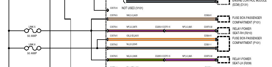

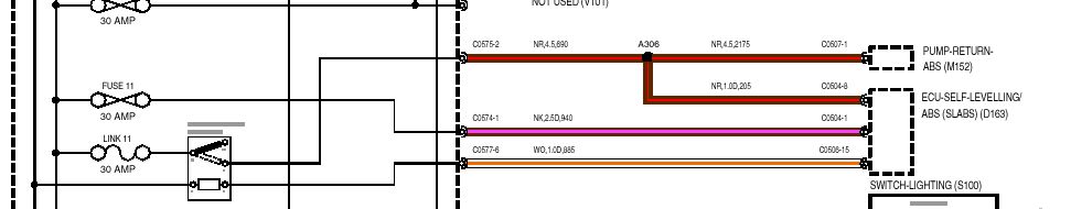

Not sure if this helps or not.

Thanks for the diagram, any thoughts as to why there might be a draw from either of these?
joey
Custom Rover Accessories
Staff member
Jun 28, 2004
10,495
188
If you have SLS, then there is a chance that it is running...
Since Link 5 feeds the internal fuse box, could be a light stuck on or there may be a fuse in there for the SLS as well, which would be why your fix with either item removed.
